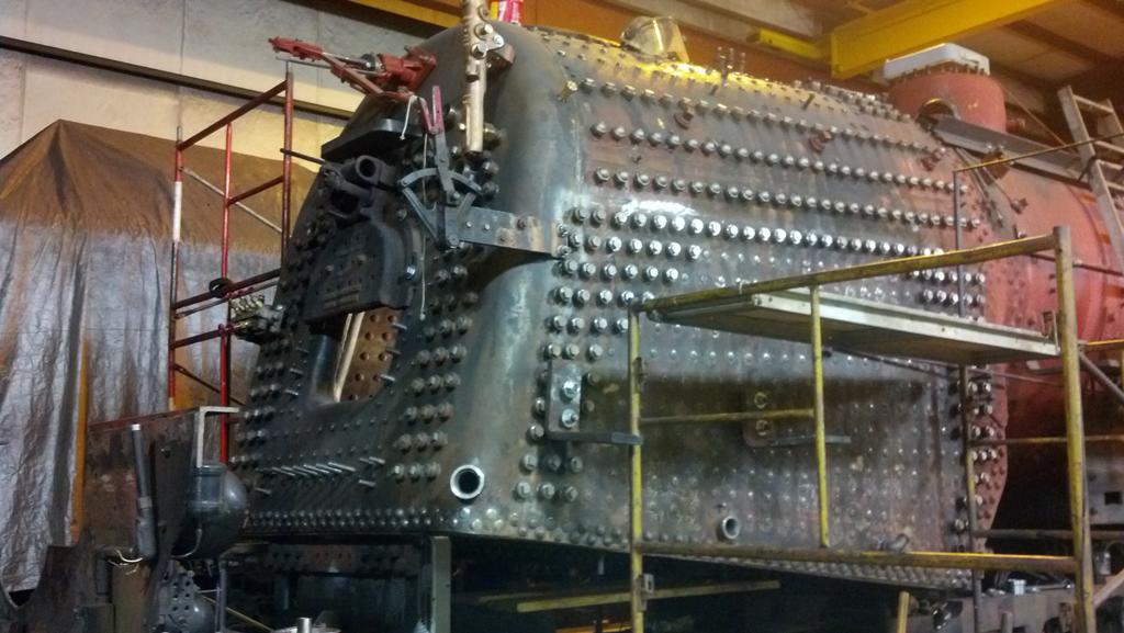

Here is the latest news from the TVRM shop.

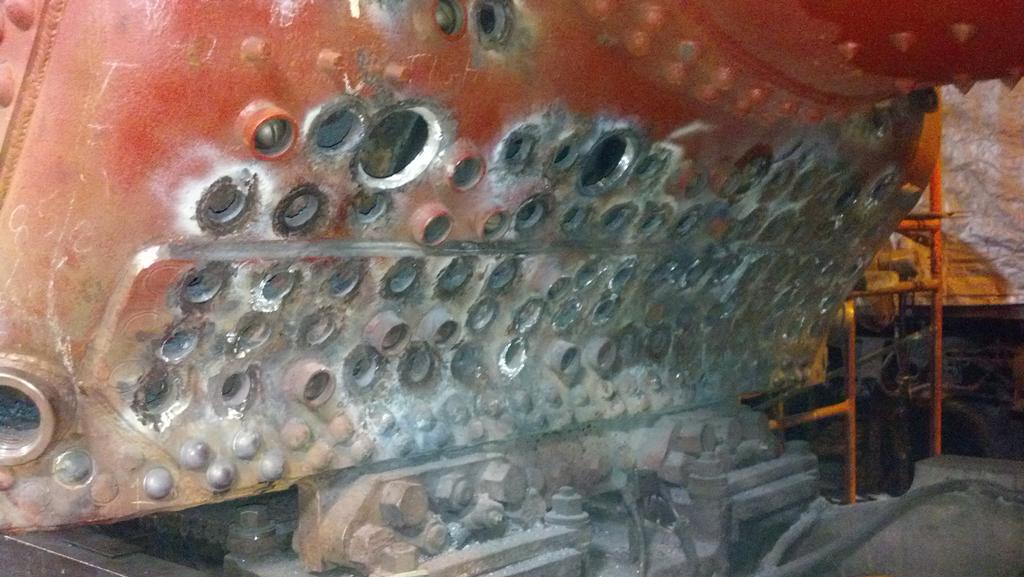

4501 Boiler Work is now focused on the throat sheet with flexible cap and sleeve replacement underway. Huron sleeves are being installed in place of the bronze plugs for the arch tube washouts. The crown bolts have been trimmed and are being prepped for driving. The rear corners are all complete and the only the bolts remain for the front corners. Finally, assemble of the Form 4 Package is underway. Boiler pressure will remain at least 200 psi.

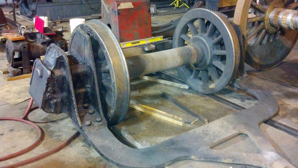

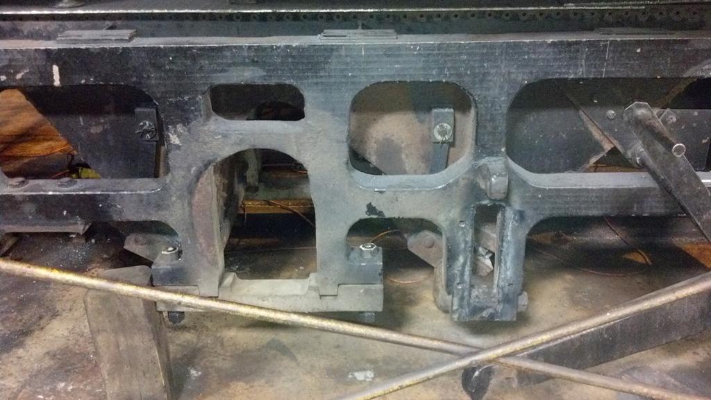

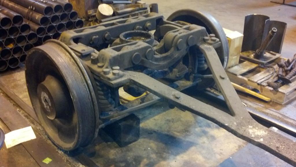

The lead and trailing trucks were removed this week. This will allow installation of roller bearing equipped axles to both the lead and trailing trucks. The spring rigging has been dismantled the rear half. This allowed better access to areas of the throat sheet.

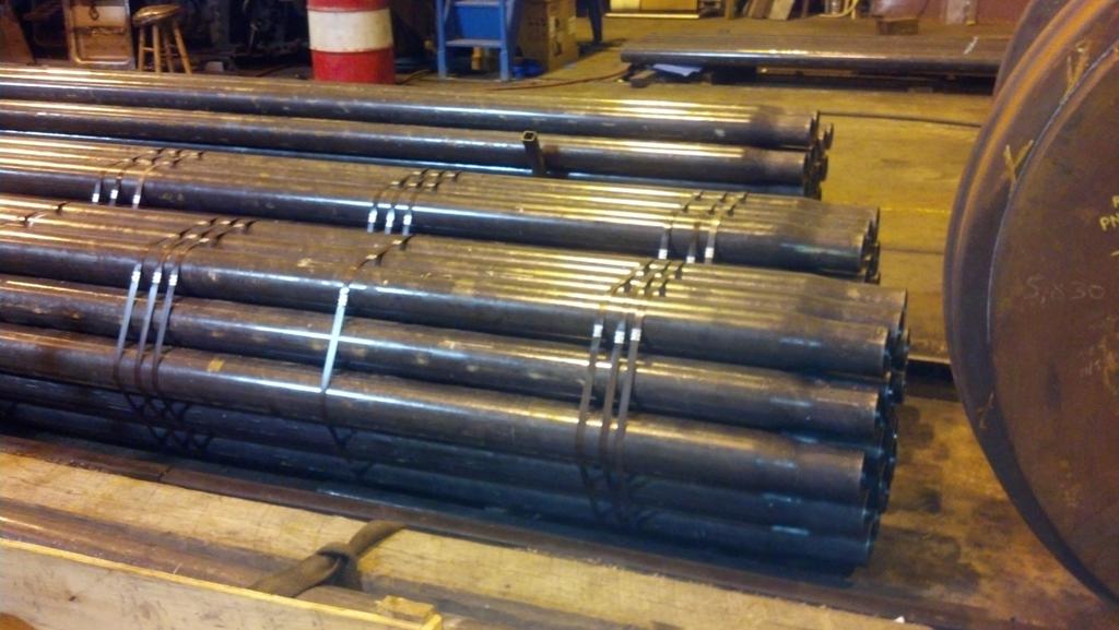

Other work in the shop includes some wintertime maintenance on 630. She has received her annual inspection and some attention to her main rods. We also are doing a contract flue swaging job for Anderson Tube. Finally, the hot water pump for the 765 is being overhauled by others in our shop.

File comment: Trailing Truck after removal
File comment: Worn Out First Generation Hodges Trailing Truck
File comment: Right Rear Corner of Boiler

File comment: Throat Sheet Work
File comment: Rear Frame Extension
File comment: Flue swaging job
