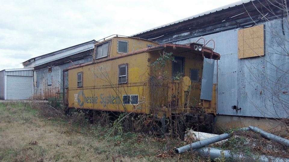

Thanks for the information. It will take some work to do for the ole' caboose, but we will just have to see how things go.

NRHS has an annual grant program which is available now via the NRHS web page and if you search RyPN you will find a recent thread on a new foundation. Again, though, being a 501c is probably key.
By the looks of the one picture you have posted the caboose seems to be in decent condition, especially the lower side sheets.
