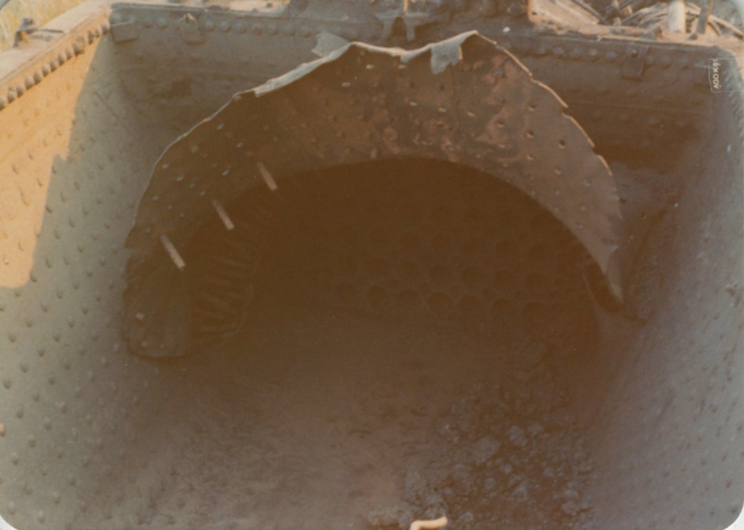

As Trevor's photos graphicly illustrate, EFDTC No. 312, a meter gauge 2-10-4 built by ALCO suffered a exploision on August 15, 1981.
Unlike the Lynn boiler, No. 312 did not have a lap riveted boiler, it had typical butt strap construction.
More importantly, this explosion was due to mechanical failure, not low water.
In February 1982, Dennis Daugherty and I visited Tubaro, Brazil and were given a tour of their extensive shop facilities by one of their Assistant Mechanical Engineers, who spoke excellent English. As part of the tour, he showed us the remains of No.312.
The welded seam between the left side sheet and the combustion chamber "ear" was torn open for about 18". The weld had been inspected and no fault could be found with it.
The weld had failed because it had insufficient support due to mulitple broken adjacent flexible staybolts.
It was stated that the railroad had experience an upsurge in traffic and that to keep the locomotives out on the road, broken staybolts were often plugged rather than renewed, the shop planning to do the renewals in the future. One problem was that no record was kept of which bolts were broken...
Eventually enough adjacent bolts broke and the seam, now with insufficient support failed.

This image on the same subject was sent to me recently.

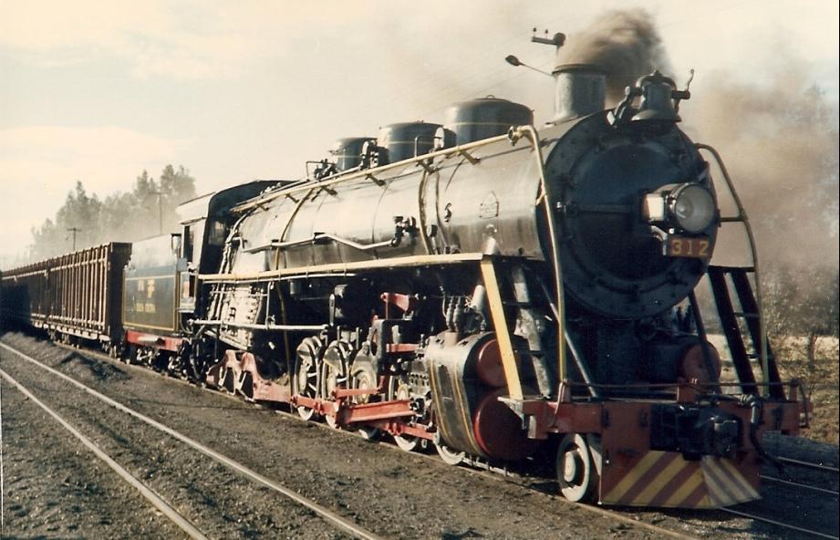

FYI Here is a photo of the loco taken a few days before the incident
TH

 Post subject: Re: EFDTC No. 312 explosion, August 15, 1981
PostPosted: Sat Jan 19, 2013 9:45 pm
Posts: 705
The first posting says "built by Alco," but the photo shows a BLW builder's plate.
Which is correct?

David, et al:
You are correct: EFDTC No. 312 was built by Baldwin, not ALCO.

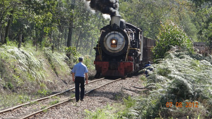

The July 2012 revenue run with 18 loaded coal cars was the first for many years. It is correct that from time to time the railroad asks to borrow a steam loco from the museum while a diesel is being overhauled but this is usually for shunting only.
The primary reason for the July 2012 run was to validate the ability of the loco / crew for a week of steam hauled activity in July 2013 for the German tour operator FarRail when it is intended to replicate the daily activity from the late 1980's including loaded coal trains to the port of Imbituba an activity that is now completely finished steam or diesel.

A couple of tidbits that I found on the internet while trying to find out some info on the 2-10-2 replacements for the 2-10-4's:
1. The engines were originally numbered in the 400's when in Argentina, but EFDTC renumbered them into the 200's (the one in the photo above is apparently then #205) not in numerical sequence from their old numbers.
2. The EFDTC liked the looks of the boiler front hanging bells on the 2-10-4's so put NON-WORKING bells of that type on the "used" 2-10-2's. Kind of interesting I think.
3. L.D. Porta "improved" some of the engines and from the larger stack on number 205 in the photo, it looks like this might be one of them.
