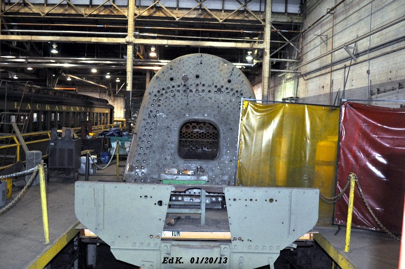

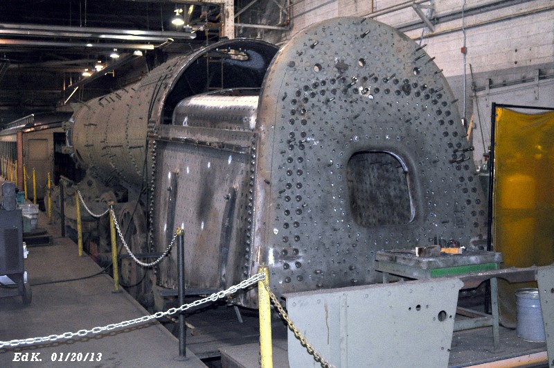

At Steamtown Sunday 01/20. work progresses slowly on 3713, shown a new fire box, and back head, stay bolts have been replaced, don't look for her to run for at least five years from now, she progresses as funds, and personal allow.
Ed K. cp Laurel Run

Noting how far this engine is from completion and how the 3254 is nearing the limits of its serviceability, would it be prudent to move ahead with the rebuild of 2317 after 26's completion?

Loaded question. Who is going to opt for less steam at Steamtown? Actually, 3713 has come along fairly well since I last saw her in May, 2012. Baldwin 26 looks much as she did, at least in my eyes, at that same date.
I'd love to know what's on the official docket for restoration. I was told by the shop people that they discuss this topic regularly. Rahway Valley #15 is spoken of regularly. The Canadian Pacific 4-6-2 has just come off the running line, so it's probably closest to a quicker fix. We all have a short list of Steamtown locomotives we'd love to see fired again, in my hopes I'd like to see MEC 519 and CNR 47 go into tear down and rebuild.
A national "press" to supplement funding for 3713 would be a good way to empty that particular stall. Thinking aloud.

3254 has issues and may or may not be operable this season. The question is if it would be wise to invest the money and man power to keep her limping along, or to divert it to other projects. Her clock runs out in 2016. Long range, she may be retired to static and parts mike 3377 brought back online. I think she only had 500 miles on her after class 5 repairs before being put in the dead line.
Fan favorite 2317 will be the next Canadian engine to return to operation. While SNHS takes a lot of flack for running non-US locomotives, they will continue to do so as they allow the park to offer the steam experience while not consuming the American pieces. She does have some quirks and the big question in my mind is how much they will find that needs to be corrected when they open her up.
3713 is coming along fine. Do not forget that she is almost or completely funded by an outside entity and most labor comes through a private contractor. The group in charge of her has spent a lot of money lately stock piling parts so that when help from the SNHS shop comes available, they will not be waiting on parts to be fabricated and can dig right in.
26 should be operable this season, she is entering final assy. From what I am hearing, once 26 is up, the staff will be split with half going to work on 3713 and the other half starting the tear down on 2317 for her 1472 work. That will dictate which is out first, 2317 or 3713, depending on what is found on '17.

Looks like 26 will be out this summer. Then all personal will be moved over to the 3713 project. So I was told.
