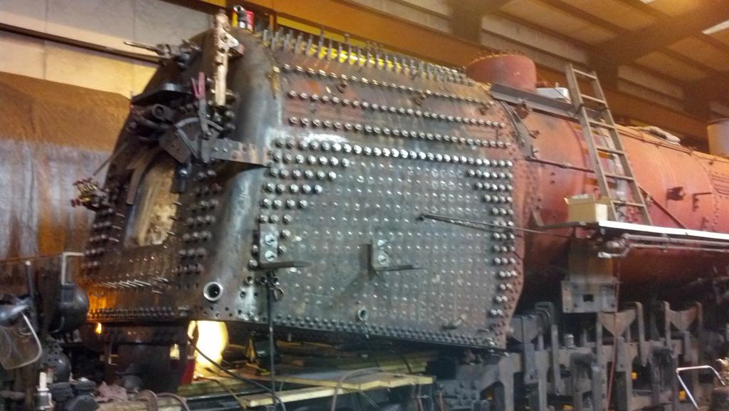

Boiler - All the corner pieces are welded in and are ready for mud ring rivets and staybolts. Many backhead fittings have been applied including the throttle stuffing box, water column, and fire door. We still have some bolts to drive on the exterior and finish out the weld to the new flush patch.

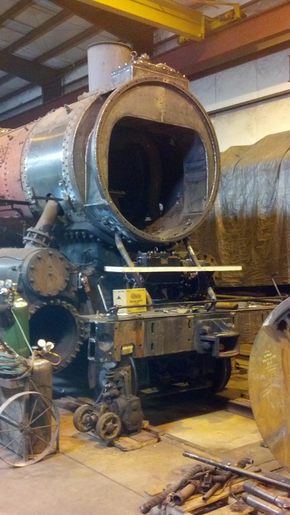

Running Gear - The new roller bearing equipped wheelset for the lead truck has been orderd. The driving boxes are being readied for crown brass, hub liners, and babitting. All eight have been repaired and reslotted. We expect to remove the lead and trailing trucks within the next two weeks and begin overhaul of those. We are going to fit the traling truck with a roller bearing wheelset as well. Machining on the 1, 2 and 4 driving wheels is complete. The new crank pins for the main are expected in the next few days. The rods will be sent out next week for check of centers and potential boring of rod eyes.

File comment: Rear of the boiler showing the fittings now installed.
File comment: Front of the boiler showing the pilot removed to allow for lifting and removal of the lead truck

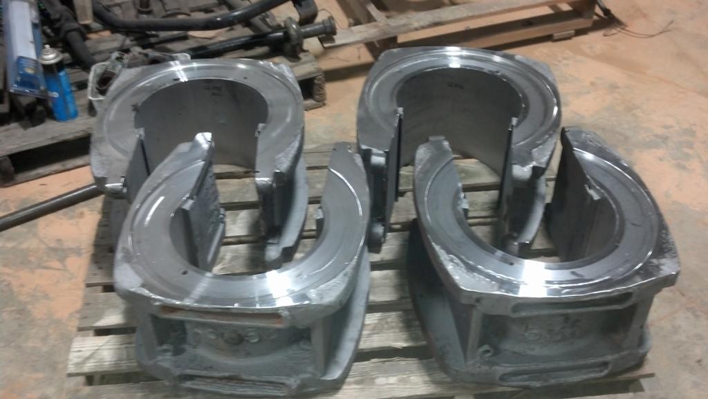

File comment: 4 of the eight driving boxes after having the radius recut on the slotter
