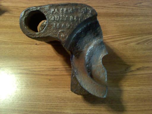

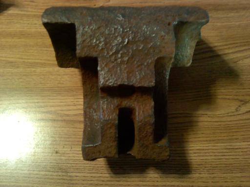

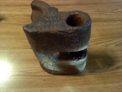

Anybody recognize what kind of knuckle this might be? I lugged this home a few years ago after finding it in the river. The only reason i bothered to bring it home was because it was rather different looking than most i've seen and had a old patent date somewhat visble on top. It is slottted and has the hole for a coupling pin to hold a link in but has no knuckle pin hole like most knuckles.
I have 2 other old slotted knuckles in my old RR iron collection that are slightly smaller in size but they both have the other hole for the knuckle pin. I can't see or tell where any iron is broke off this one but i'm kinda puzzeled as to what held it in place in the coupler drawhead?
It weighs approx. 50lbs. and has "Patented July, what looks like a 24 and what looks like 1889. and has a circular shaped logo with something inside the circle that i can't make out.
I have changed a few knuckles in my RR career over the past 20 years so i know what type E & F knuckles look like and that there is a difference but this old knuckle has me stumped! Thank's for any reply's and insight on this old rusty hunk of iron!
Fritz

Here's another photo if it helps any.

I can say what its not.
Its not an AAR -10 or -10A, the predecessors to those were the MCB -10 or MCB-5, its not one of those.
It appears to be from one of the early patented coupler's (there were about one hundred of them, an example would be the early Janney coupler, before it got an MCB contour).
Look it up in the old "Car Builders Cyclopedia" Google and other Co's have them scanned.

It kinda looks like this one: http://en.wikipedia.org/wiki/File:Syracuse-malleable_1899.jpg
--Drew Black

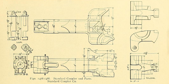

However...could this be it? From page 233 of the 1906 Car Builder's Dictionary:
Regards,
Josh B.

Utah Josh, Your attachment from page 233 of the 1906 Car Builders Dictionary looks like it is the same knuckle! I looked at the knuckle i have more closely and there is a very slight angled break in the casting just behind that raised 1/2 circle part of the casting.So evidently the far right/back smaller casting part broke off the knuckle that is shown in your top right side view diagram. I'm still a bit stumped on what held the darn thing in place though as it has no knuckle pin/hole unless it was the raised 1/2 circle part of the casting wich held it in place?
Guess that's why it ended up in the river since the back pc. broke off! I didn't realize there were so many different types of Janney couplers made by various manufacturers back then with different types of knuckles. Even if they were all developed and compatible with MCB couplers one would think that it had to be a nightmare for railroaders on line of road if one failed and they didn't have a proper replacement knuckle to fit.
Thank you all for the replies and research in helping solve this knuckle of a mystery!
