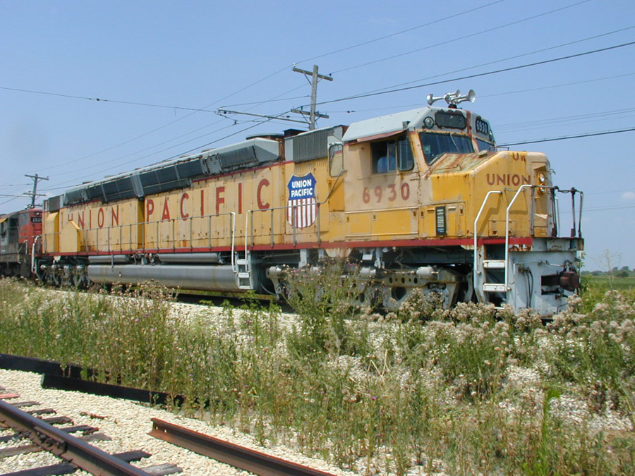

Lincoln Penn wrote:
The DDA40X's were the first with dash-2 modules.
Partially correct, the 6900's have a modular electrical system, but the modules are mostly incompatible with dash-2's
You guys need to be aware that these things went through Omaha Shop for parts salvage before being donated or sold. During that process, any "common" parts with life left in them were removed. In some cases, these parts were replaced with junk parts; in other cases they weren't replaced at all.
For example, "bare blocks" would be installed in place of complete engines. At first glance it looks complete but open a few covers (if they are not welded in place to prevent just such snooping) and you find no power assemblies or camshafts or crankshafts, or you find only burned, broken or blown up internals and auxiliaries such as turbos, governors, oil, water and fuel pumps, etc. Same thing with alternators and traction motors, grids, blowers, cooling fans, radiators, etc.
It's pretty safe to say that if an important part is left on one of these units, either the part you are looking at has problems, is hollow, or was left on by mistake.
True, 6930 at IRM has oil pans full of broken engine parts, although both engines do have crankshafts
The main difference in the engines is the governor rack setting.
...and the turbos, wrist pins, among MANY other internal changes
