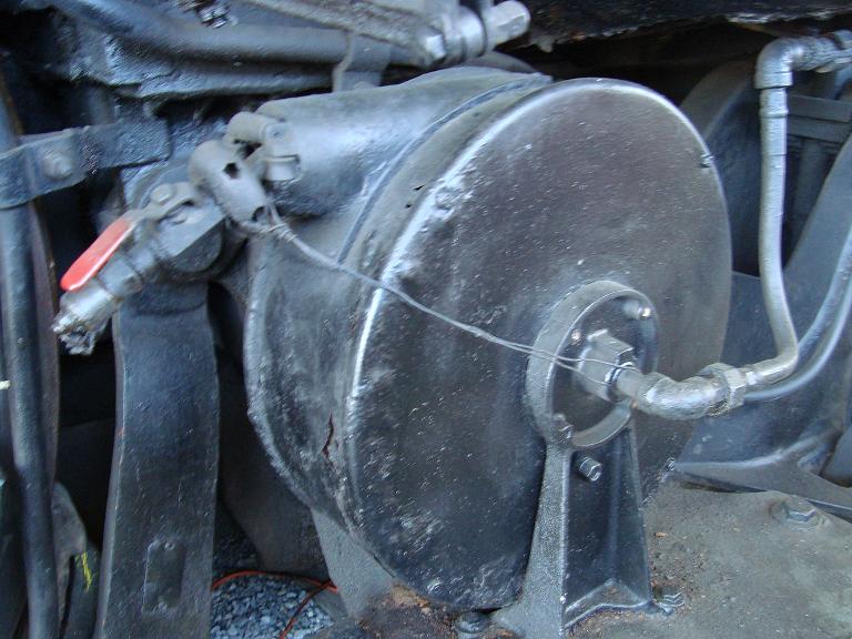

I bought a used DVD on the 614 and was wondering about a part on the engine. On the fireman's side, in the front of the rear truck, there is a thing that looks like a hose reel. What would this part be for? This piece doesn't show in the C&O book by Stauffer.

I was also interested in it when I went to the VMT in April, 2011. I took a (blurry) photo of the wheel. If I recall correctly, it is a retractable airline...a neat concept, at least to me.
File comment: Sorry about the blurriness.

Looks like either a water or air hose reel.

Ross will have to chime in wa-for, but looks like to me a couple of things, give the engine a minor spray washdown, or flush out the cinders. Probably very handy since we don't have regular steam locomotive district shops for an end run servicing.

I believe is a lube filling line. Can't remember for the life of me if it was for the siderods or otherwise. Hagerstown in 1986 is too many years ago. I could be wrong. Hopefully Ross or a few others will jog my memory.

I'm pretty sure it's a lube hose. The locomotive originally had an odd-ball Hancock (?) feedwater heater that was mounted on that bracket. IIRC, the C&O replaced the feedwater heater with a second injector when the locomotive was pulled out of storage for coal train service in the mid-50's. (Problems with these heaters? Parts availability?) I guess someone figured it was a shame to let a ready-made mounting bracket go to waste and came up with idea of mounting the grease lube reel there.

Yes, the retractable reel was for lubricating the side rod roller bearings. The feed line for it passed between the engine and tender as well as the tender to the auxillary tender. Quick disconnect fittings were used between the each piece. The 55 gallon oil drum was located in the 'oil room' of the auxillary.
The oil drum had an air operated pump that kept the entire lube line pressurized that
kicked on once the lubing of the rods started. This system was very handy during servicing stops.

As Tim described it made the oiling of the side rod rollers a whole lot quicker and easier and reduced the time we needed at a service stop materially. The oil room in the 614A aux. tender is also steam heated so that the barrels were kept nice and warm even if the ambient temp was below zero.
The system works very well and got a real test during the month long coal train tests in 1985 when on some days the wind chill was minus 45. On one day 614 was the only engine to get over the division as the diesels all had fuel freeze up issues.
