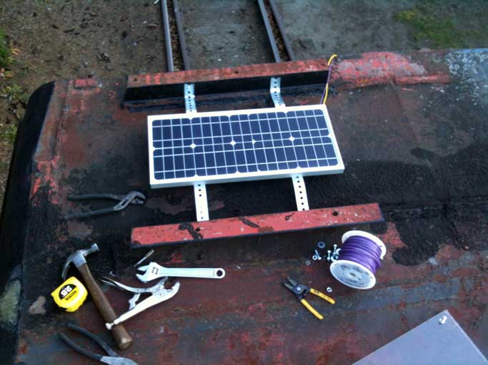

The Southern Michigan Railroad Society bought two cabooses from Conrail in 1985. These are used for passenger operation. These were wired for 12V electrical power, and were supplied with circa-1970 Edison batteries. Last year I cleaned one up with a vinegar soaked rag, and charged it.
It worked.
At first, the battery could be easily exhausted. Then the interior lights, desk lamp and marker were replaced with LED bulbs. This is fairly well concealed behind the original lenses. The rear marker is brighter and draws 0.08 amps (1 watt). The interior lights no longer flicker when lights or the marker switches on and off.
The caboose parks far from a power plug. Running extension cords was a major chore. So this was attached to the irons which once held the roof walk.
File comment: Solar panel on SMRS Caboose 19851. The wires use the official Willy Wonka color codes.
The strapping material "springs" in place and is held only by one bolt in the corner. Above it, a sheet of plexiglass (lower right corner) is bolted across the irons to protect it from branch hits. The wires were routed properly later.
Below decks, it connects through a top maker's least expensive charge controller to the battery. This prevents overcharge of a lead-acid; it doesn't get near overcharge for an Edison. It also uses PWM to turn overvoltage into more useful current. Aside from the addition of this module, the original battery wiring panel is unchanged.
The panel is rated at 20W (aimed straight at the sun and not covered with dirty plexiglass), so I expect 5-10 watts out of it. The panel was sized for the available space, though I later learned a 30W panel would have fit. Measure twice... sigh! There's a similar site at the other end of the caboose.
In the month since it was installed, there have been several revenue trips, much use, and no plugging in chargers. Nonetheless it managed a night run quite successfully, burning a rather bright LED headlight.
Since operations are generally once a week, this serves as a completely automatic way keep the battery topped up and ready. The solar panel is rated at 20W if aimed directly at the sun and not covered by dirty scratched up plexiglas. I expect 5-10 watts ordinarily, given that it has a whole week to top up in most cases. During consecutive days of operation, the crew would probably need to cut the headlight when not near crossings, or top up with a battery charger. This is December, so the light will only get better.
I'm rather pleased with the results so far :)

Very interesting way of integrating modern technology with operations. May I assume the solar panel is waterproof? The only question I have is whether the plexiglass affects the wavelengths of the light coming in. You'd have to run tests both with and without the protective plastic, but right now, if it works, so much the better!

> waterproof?
You bet. They live outside. This one more than most, the builder was a real fan of epoxy (or hopefully, urethane "epoxy" as it is UV resistant). Many solar panels have a little junction box with terminals inside. Not this one, it just had 6" wires coming out of a potted box.

The primary motivation in this caboose (OP) was to preserve the Edison battery. The only "green" was green extension cords, specifically, not having to run them! Because historically nobody ever bothered, which is why the battery had been neglected in the first place. Anyway everyone presumed the battery was long-dead, since conventional wisdom is batteries last 5-10 years.
Now with the solar panel, the battery gets used, and displayed. People get another think about that conventional wisdom. Which has an impact on electric cars, homepower and other 21st century energy management strategies that make a lot more sense with a more durable battery. So I guess it is kinda green!

I'm happy to give an update after a year of actual use.
First, the system works exactly as intended. No one had touched the system since December, they went to use it in May, and it ... just worked. The battery stays "topped up" and is not overcharged and does not use water excessively. (the controller is intended for lead-acid batteries and will tend to undercharge a nickel-iron.)
Concerns about undercharging and sizing were tested this cloudy October with three 3-day weekends in a row, Thurs-Sat-Sun, Thurs-Sat-Sun, Fri-Sat-Sun. All using the big headlight continuously the whole trip, for backing moves, so 3 hours a day. I expected the final back-to-back 3 days to finally exhaust it, but it didn't.
