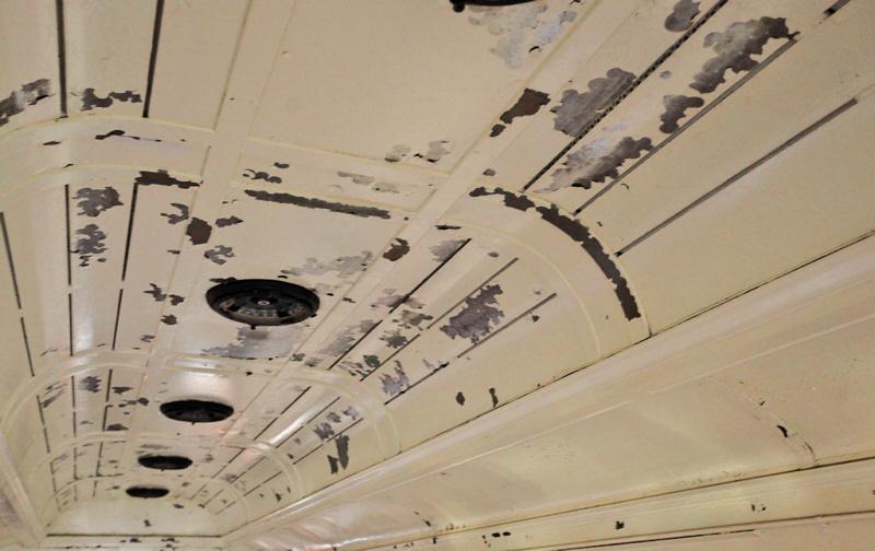

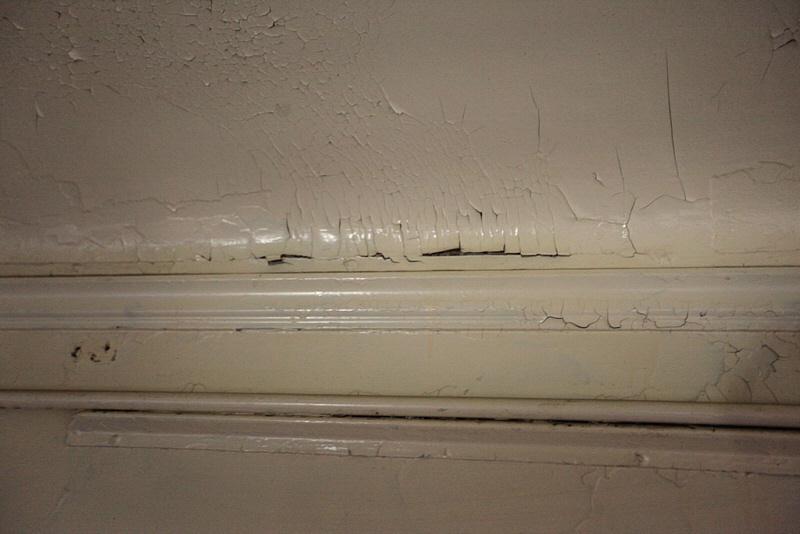

I'm at the North Carolina Transportation Museum working on bringing back a Southern Heavyweight Coach (built ~1920) for the train. The interior paint is peeling and the remainder difficult to remove (see pictures). It has been painted many times somewhat sloppily. The majority of the walls and ceiling is galvanized sheet metal. Some has been replacement thin Masonite. Except for one end and a few other spots the metal is in good shape. It was suggested I power wash it. All that did was get me wet and cold. The pictures are post power washing.
I have no interest in spending a couple weeks on a ladder working over my head with paint stripper so I'm looking for other ideas. If you are into using paint stripper over your head, come on down.
Sand blasting has been suggested but the sheet metal is rather thin and the paint quite hard. (The outside of the car will be sand blasted.)
Ideas please. Thanks.

Afraid there is no easy way to strip paint off the roof of a passenger car that doesn't involve a lot of overhead scraping work. From the looks of the pictures, I'd say 100% probability of lead paint involved too, so keep that in mind while inhaling the dust (At least using chemical stripper minimizes that risk). I might suggest you try a needle gun in an inconspicuous place to see if the paint can be removed without pock marking the steel. Failing that you could try a heat gun (Like an industrial strength hair dryer) and see what if any effect it has on the paint. One way or another though, you are in for a lot of overhead work if you want it to look pretty again...been there, done that.

How about corn cob or baking soda blasting? On something like a metal coach interior, with lots of formed moldings and angles, some form of mild blasting media will take the paint off comparatively easily. Shouldn't do any harm to the underlying metal, or anything else for that matter. A bit of a mess to sweep up afterward, but much faster than any traditional heat gun or paste/liquid stripper.

We are currently soda blasting the interior of an E.M.D. cab. About 3 layers of paint. Went quick. Masonite looks almost like it was just put up. Steel parts look great. The Soda blasting rig was about 100 bucks from Eastman.
Many benefits over traditional abrasives. We use fine black beauty and it is great outside but would never dream of doing what we a doing with Soda.
From what I saw in the pictures it would make short work of it, wipe it off the blasting dust and you would probably be OK to paint.
One other thing claimed with soda blasting is it leaves a light film that slows up rust.

I'm working on this car alongside Marty, and I attacked the paint problem this weekend myself. I ended up taking a pretty heavy-duty wire brush on an angle grinder, and that started having a good effect. The peeling sections disappeared, and the areas where paint was not stripped properly before painting over it was smoothed down as well. In short, attacking it with the wire brush worked. However, it is a daunting proposition to hold an angle grinder above your head with a 5 in steel wire brush all day to get the ceiling. :) Additionally, the hardboard/masonite sections likely would not survive such a brush.
