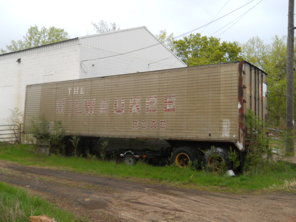

The Colfax railroad Museum, in Colfax, WI has just been notified that we have the opportunity to receive a 40' semi trailer that was used by the Milwaukee road. This may be the only remaining trailer in original condition. It is in excellent body condition, but cannot be simply pulled to our site due to 15 years of bearing freeze. We need assistance to raise the $1500 needed to move the trailer to our site and build a concrete pad and support to display it properly. Any financial assistance would be appreciated. We are a 501(c)3 nonprofit.

One thing you might want to try is to talk to a truck repair place near the trailer and see if it would be possible to swap the wheel set or just the axles.
From the photo it looks like the trailer has a sliding wheel unit, if you find another bogie with the same slide dimensions you could swap them out and then transport it with a tow truck over the road. If not a slider then it is just 4 U-Bolts and an air hose per Axle to change them out.
Rich C.
 Post subject: Re: Milwaukee Road 40' Trailer Being Preserved
PostPosted: Thu May 10, 2012 5:24 pm
Are you sure the bearings are bad? The majority of the time the brake shoes seize/rust to the brake drum after sitting for a long period of time. To unfreeze you hook air up to the red gladhand and beat on the drum or get a long punch and hit the brake shoes. You can tell if the brakes are released by hitting the brake drum and it rings.

Something here doesn't make sense. Have a competent mechanic inspect the rig. Rusted brakes can be broken loose as described above. Make sure the air lines are good.
You might need a "trip permit" to move it to your location. You will want to check lights - at least brake, turn, and running lights.
None of this should come anywhere near $1500.00.

OK I can see the $400 to move it. Crane? No. Concrete pad? No. It will sit on its own wheels just fine, and maybe every few years have a tractor come in, couple up and drive it around the block a couple of times to exercise the bearings and brakes. The tires should be 10.00x20 which are readily available, tube type as well so if one goes flat just have the tube replaced. I concur that the brakes are probably just stuck in position and need to be freed up. Very,very, very common thing to happen to trailers sitting still for too long.
No permits should be needed to move the trailer if a sign is placed on it saying "Tool Trailer". At least around here if a semi is labeled as such and is empty its pretty much exempt from a lot of scrutiny.
There, we just saved you $1,100 in costs.

As with the others, I doubt the bearings are your problem, the brakes are almost certainly the issue.
Try checking with a heavy duty towing company. They can probably move the unit on its own wheels (if the rubber is semi-decent), and depending on the laws in your state they may not require a trip permit or safety certificate. It's under tow, after all.
You might want to check around with local trucking companies as well, who might be happy to donate worn tires to you. They would avoid disposal costs and would be helping you- a win-win situation. You could throw a few sets in the trailer, out of the light and weather, and as the existing rubber disintegrates, simply change to a new old set of tires.

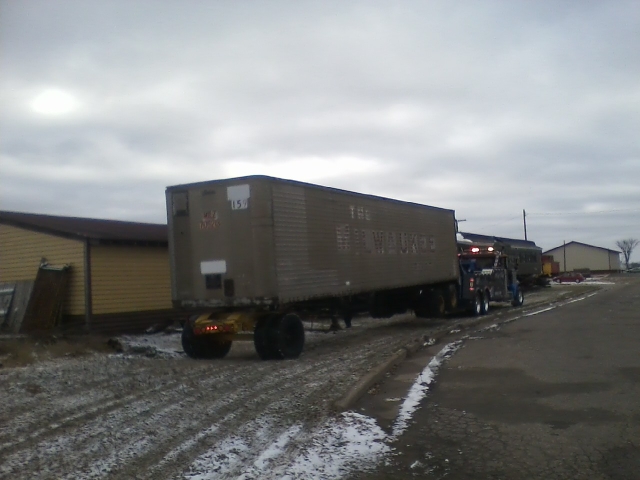

The trailer is on site. We will have to position with a crane in the next few weeks. The tow truck couldn't maneuver all the way in due to obstructions frozen to the ground(We are very tight on street clearance where we could place it). The pads are in and we will be building block cribbing to raise the wheel end JUST off the ground. It will have a ramp installed and be used for storage. The inside is all wood lined and bone dry. It is original and has all the mechanicals intact. We will need to do some priming and painting on steel parts and touch up the lettering, replace reflectors and replace the steel around the rear lights.
The trailer was brought in by inserting a towing wheelset at the front end and ltowing from the road wheel end.
We are still trying to raise the funds for the move.
