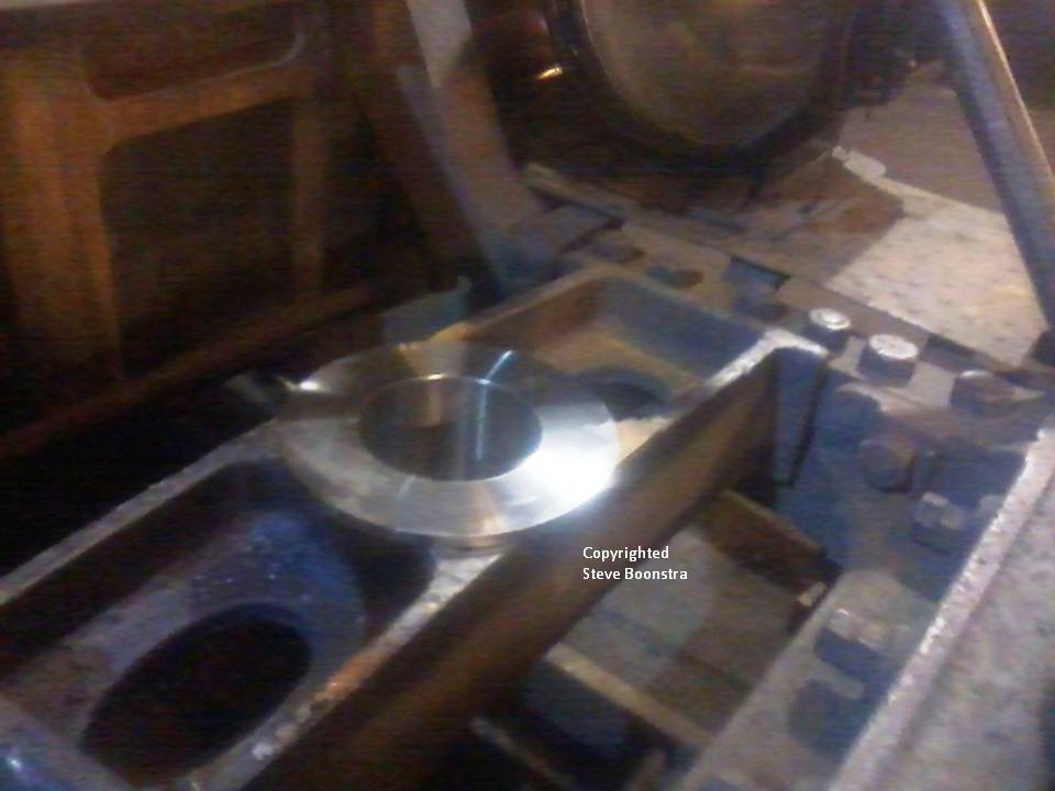

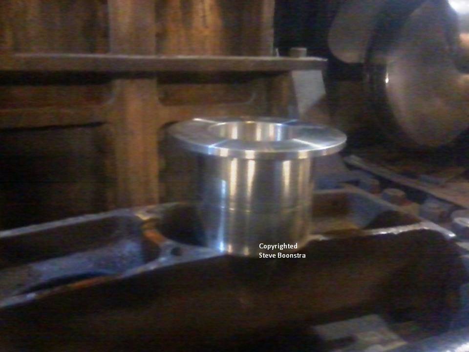

Thanks Rich. Here are the pics of the new bushing! I will get Dan to take some pics of the crosstie completed.

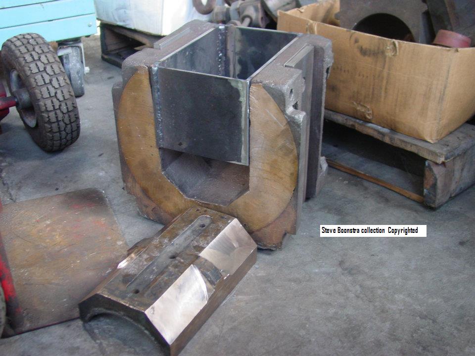

Work continues on the pilot turck for DL&W 565. We began work on the crown brass and the grease boxes yesterday. The journal boxes are shimmed to fit the frame and just need some cleaning up at the contact points, polishing.
What's left:
Need to make a center pin
Finish up the grease boxes
Finish working the brass to fit the boxes
Polish the brass where it makes contact with the axle
Then assembly of the whole thing.
Once we get everything assembled then we can check our clearance between the wheels and the journal boxes. We know we have to install brass there but not sure what our final clearances are going to be.
