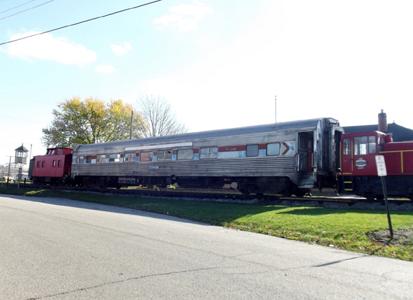

That's that car! Based on the environs, it seems that picture is at least 5 or 6 years old, in Jefferson, Ohio (east of Cleveland).
Car is now at Lake Shore Railway Museum/Lake Shore Railway Historical Society, North East, PA. Car was owned by a deceased member. His widow donated. We finally got car moved in a car swap deal.
Image from one week ago:

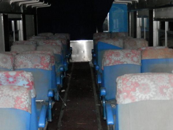

Inside of car the night it arrived. I do not know the history of the 'school bus windows' -- I think the AC unit failed and the cheaper thing to do was install the goofy windows.
We've spent about 40 volunteers hours cleaning the inside of the car so far and have upgraded its status from disgusting to just filthy. Lots more to do/will be done-- as long as the weather holds...

Ray, I'd advise checking the area around those bus windows. Having some experince with them in their intended application (due to my mother's time with Laidlaw and then Varney's Garage operating the school busses) has shown that they can't stay water-tight under heavy use for very long. Chances are that's why almost all of them use some imitation leather or vinyl for the seat upholstery. Basically, the mechanism falls appart and the windows will jam. I'd wager that a handful must have jammed open just enough to allow water into the coach. Best bet, in my mind, is to pull them and put some plexiglass in as a stop-gap until proper windows can be installed.
