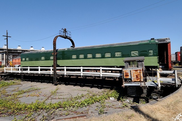

Here's what we've got so far! More roof and body work before we paint, stripe, and letter the rest of it.
Big thanks to NPRHA for helping with the paint project!
File comment: NP #498's new paint job.

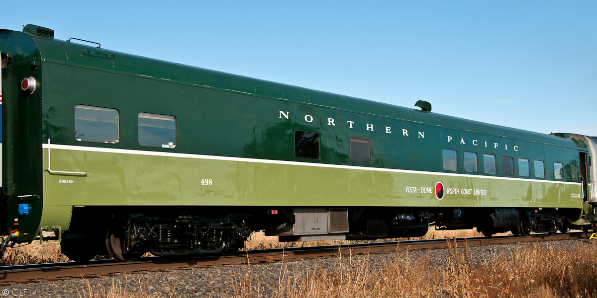

Thought I'd update this thread with the completed paint job.

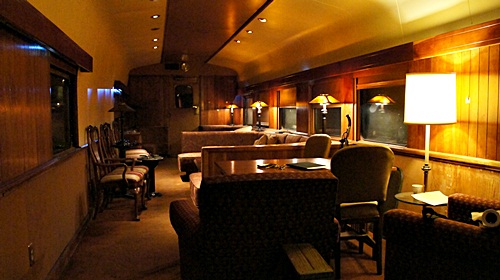

I tried digging around for high-resolution photos of the interior, but here's what I've got for now. The car is owned by the Friends of SP 4449.
