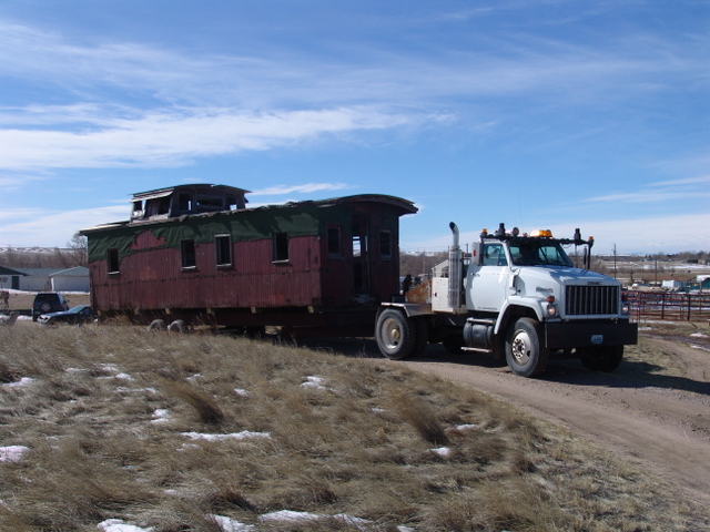

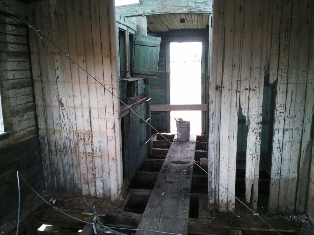

Congratulations.....she looks to be in good shape. I am sure we will be sharing info and tips as my caboose UP 2516 from 1913 is on the long road back as well.
Keep in touch
Mike Pannell

Great pictures, I thought my guy was the only person to think of putting house trailer axles under a caboose for the move.
It took a little work and the guy with the Pulling Truck just shook his head when he seen it.

I understand about house movers, my guy has shaken his head 3 times now, but its a great moving system, cheap, effective and keeps the body straight and supported for as long as you need.
Car 57 is on one too. This picture from the 'old' days of 2008 !
http://car57.zenfolio.com/p331500692/h2 ... #h2dc3ee59
Keep in touch, would like to see interior shots too if possible.
