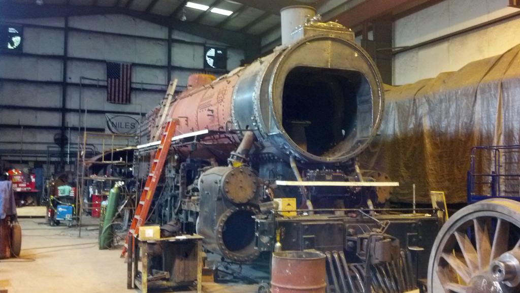

Seeing how everyone like pictures and since I've now learned how to post them here, here are some more recent progress pics.
File comment: Overall view of the locomotive. The lead and trailing trucks will be removed soon.

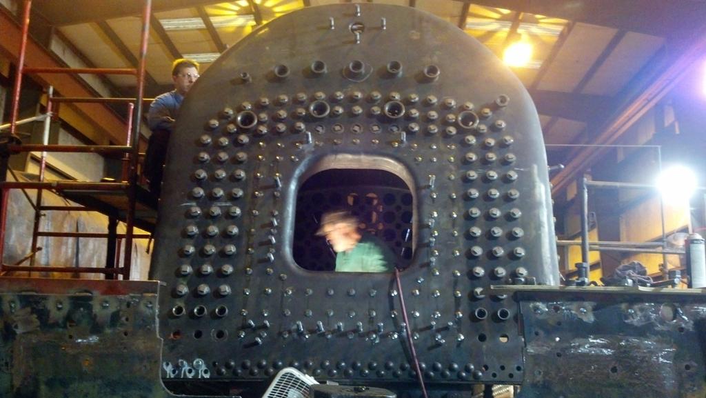

File comment: The backhead with the mounting studs for the stoker assembly installed. Crown stays were being installed.

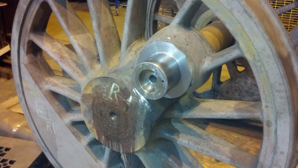

File comment: New crank pins and hubs on the #1 driver have been turned to finish size.

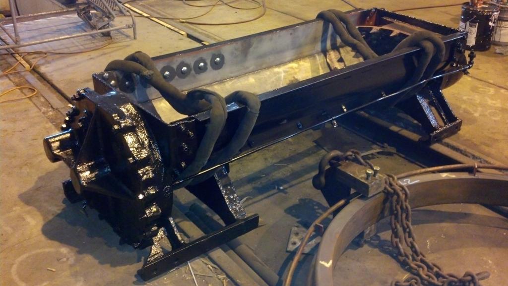

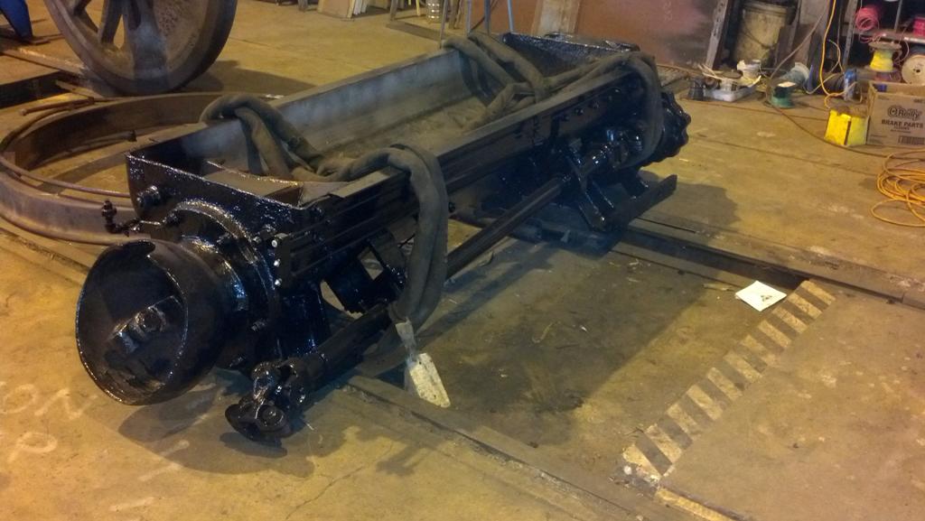

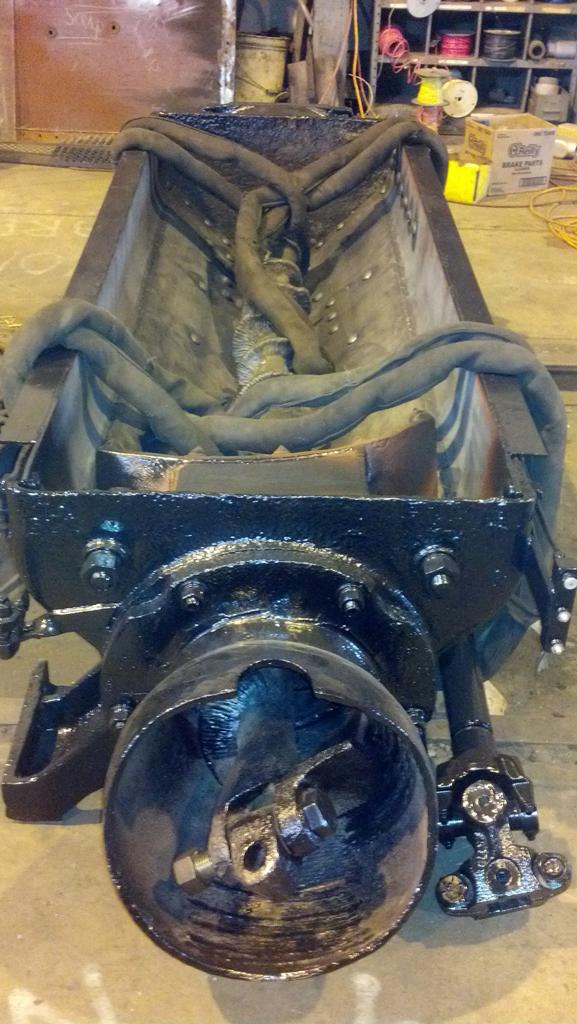

Here are three views of the stoker trough before it's installed into the tender tank.
File comment: 3/4 view of the rear and right side. A stainless steel liner was fitted into the replacement trough.
File comment: 3/4 view of the front and left side
File comment: View looking from front to rear.

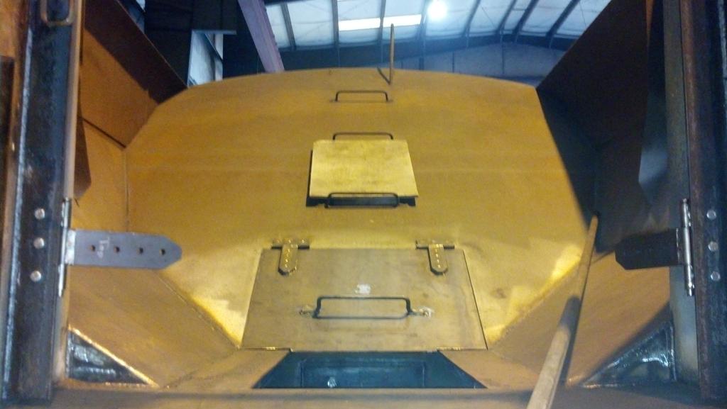

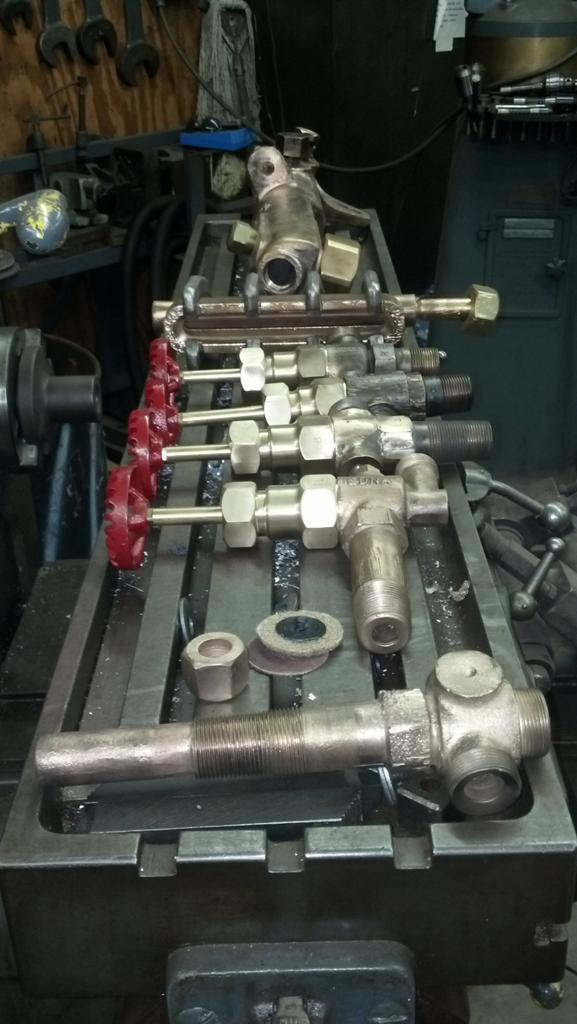

Finally, three more pics for your viewing pleasure. One shows the modifications to the coal bunker - we are adding coal gates in place of the old coal boards. The other two show work being done to the water column and associated valves.
File comment: Tender coal bunker showing modifications. Hardware is being added for new coal gates. A handbrake is also being applied.
File comment: Water Column, sight glass, tri cocks, and sight glass valves

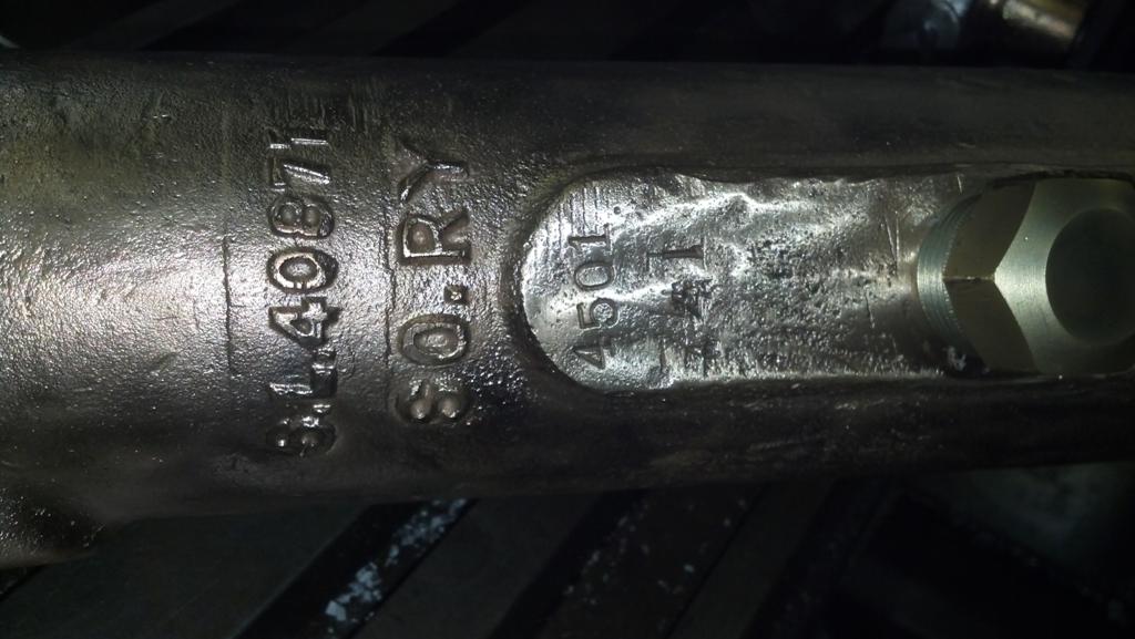

File comment: The water column is stamped "4501" but when???
