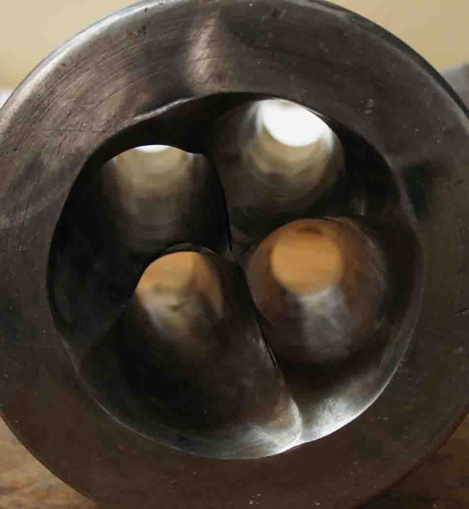

This is the exhaust nozzle assembly; Nigel says this is closer to a Lemprex than a Lempor. The Lemprex is the exhaust system Porta was developing in his last few years. The nozzle assembly includes the main nozzles, blower nozzles and vacuum ejector nozzles.

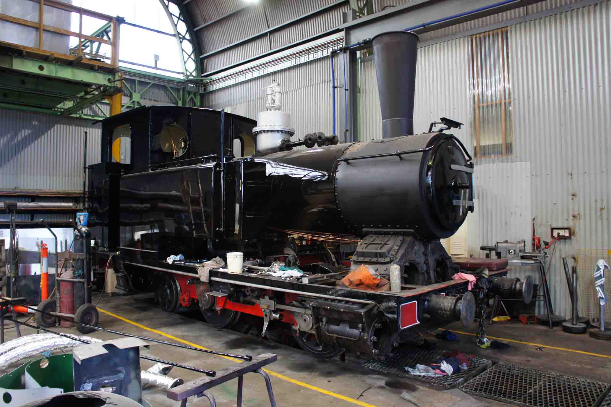

This photo shows one of their boilers which has just been re-tubed but which is awaiting other work. The whistle is a replica of a UP Big Boy whistle.

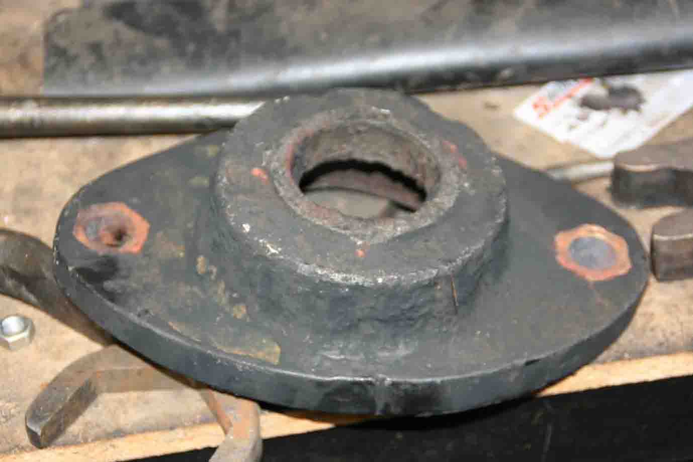

This photo appears to show pinned-in-place piston rings. (Note that UK auto maker Rolls Royce used this on their engines as well as US automaker Hudson!).

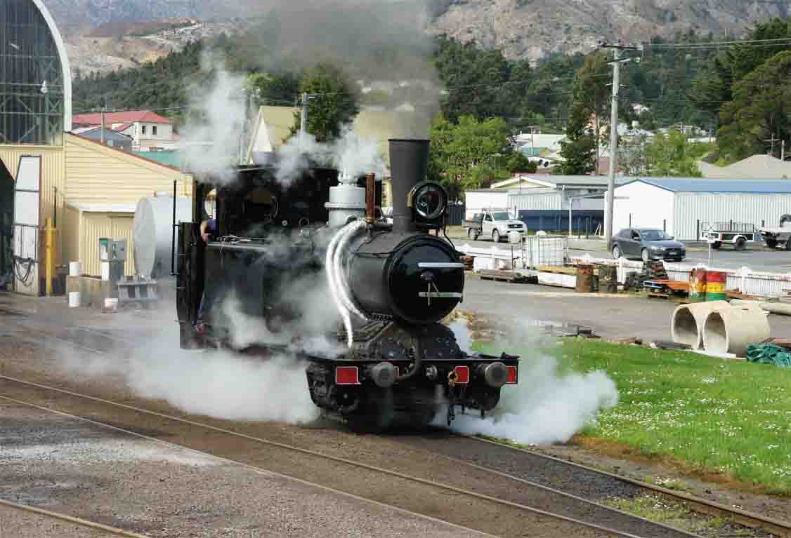

This photo shows one of the locomotives being fired up just outside the shops:
Finally, this shows one of the locomotives in service:

Abt 5 was resiving its yearly inspection resently and other work and was carried out which you see in the pictures below. Firstly the piston ring where nominaly sprung agenst the cylinder wall and 11 mm wide. We have replaced them with ones which are half that width and much more flexible. Its the steam pressure which keeps them on the cylinder bore. Compresion is so good and little force on the bore that pushing the piston in by hand it came back out when not pushed by hand. Porta claimed a loss of steam up to 30 % for bad rings and from what we did here its true. This has resulted in part of the fuel saving dicussed later. Aditionaly the super heater of small bore for the atomising has been replaced with my standard size pipe bore for that burner size. The old pipe had high turbulence, kinked and flatted sections. The standard atomising pressure range has now fallen from a maximum of around 100 psi to 20psi aproximatly. The burner now dose not stuff the firebox and its much quieter. You will see from the picture the old fire pan has been retained for now with its Laidlaw drew air pipe arangement. The centraly mounted burner now has a bayonet fitting for ease of maintainance.
The next pictures shows where a major amount of my effort has gone. The development of the Kordina from the origonal consept by Kordina has been an uneven path. The swirl system used by Porta gave varing results and I have had the consept shown here ready for testing for some time now. It is know that these locos are very poor in this area so its an ideal opitunity to build somthing more advanced. On test we have shown using compressed air that we can create a good vacuum in an oposite exhuast pipe. The whole fabrication is internaly smothed and designed to reduce turbulence to an absolute minimum.
The draughting system is baised on alot of resent work including on abt 1 It is now definatly not a Lempor. The blast pipe nozzles have a twist in them like a Lemprex but in a way to optimise mixing beyond what a Lempor dose. They like all my Lempors are designed to a Maximum working pressure of 12 psi the point where a conventional nozzle would stall and even stall the loco. They will comfortably run at a normal working back pressure of 4 to 6 pounds. The de lavel nozzles are designed specificaly to increse the velocity of the exhaust steam while not creating turbulence- the biggest issue afecting draughting and ushaly found as a limiting factor in the exhaust pipe work, certainly a contributing factor in these complex locos. the whole of this new front end will go into abt 3.
The last pictures show abt 5 in its new coat of Brunswick green on a run just after the latest mods. figures around or under 900 liters for a full return trip with a good load are now not uncommon.

Here are two pictures of the old and the new Lemprex type nozzles which illustrate the difrence in streamlinning and turbulence reduction. This leading to the significat reduction in back presure for an identical tip area. The co- eficents repectivly are aproxamatly .5 and .9 for the Lemprex
