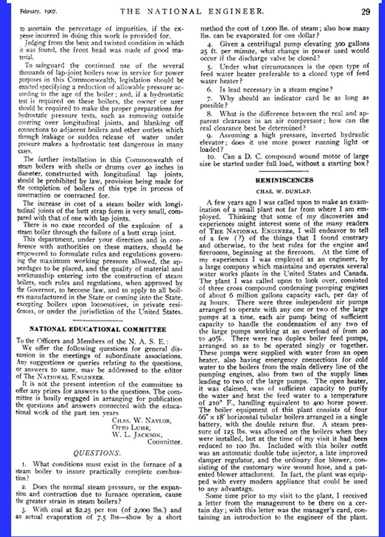

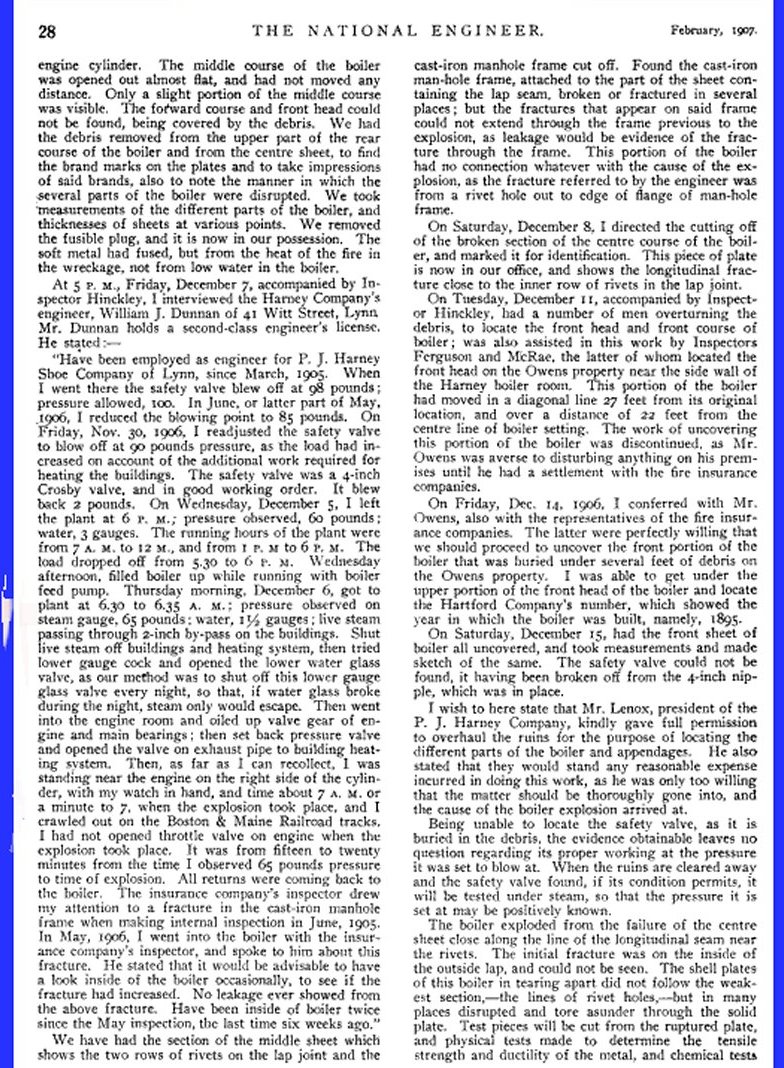

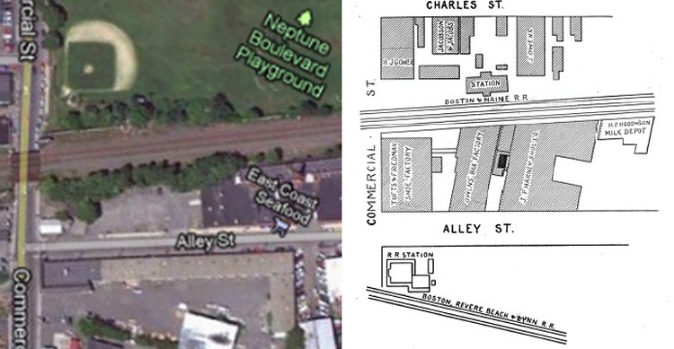

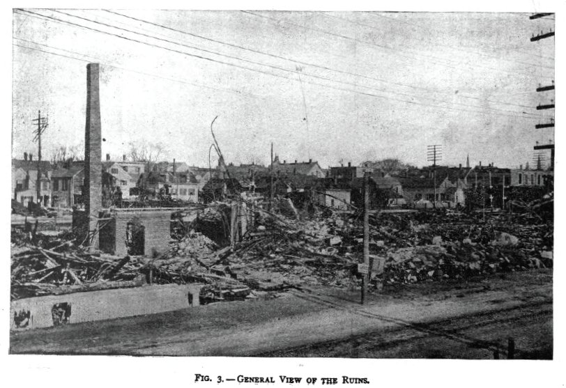

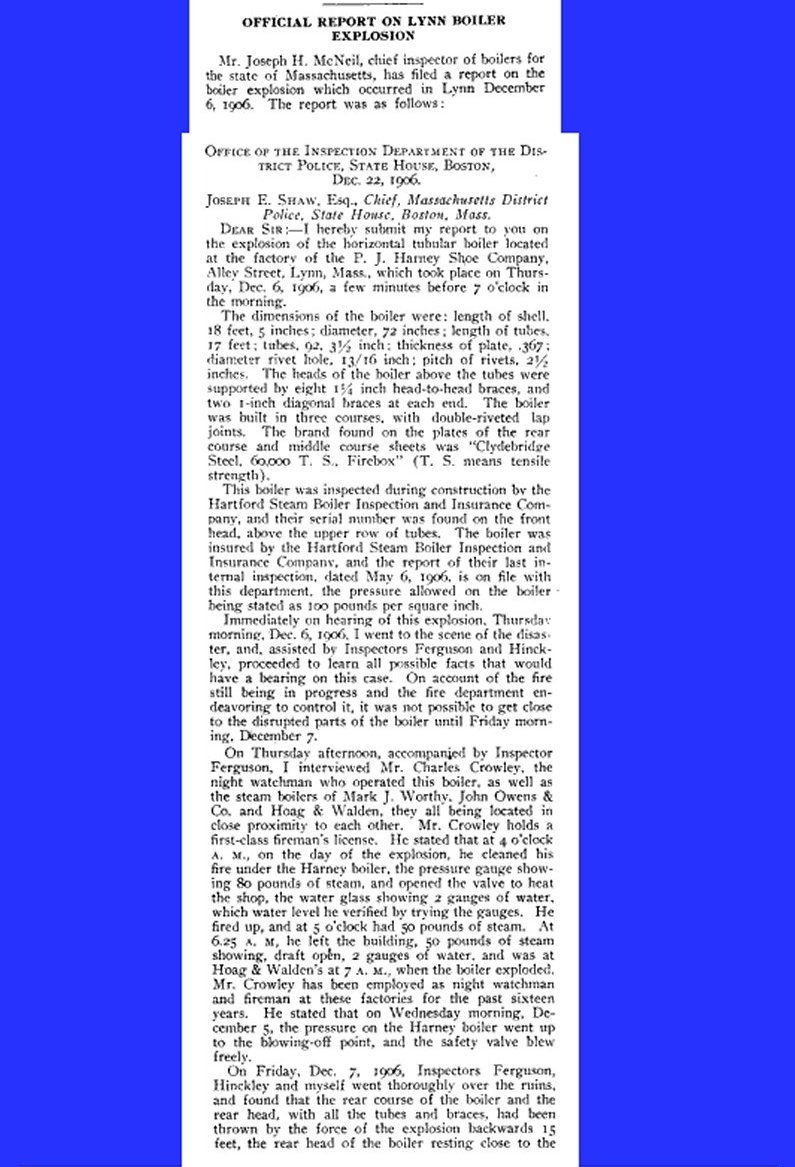

Last straw for lap joint confidence.
Note recommendation for butt joints for all boilers over 40" diameter.
The boiler had the courtesy to explode before 7am. Had it self destructed after 8am when the factory was in production as the Brockton boiler did, the death toll would have been in the hundreds. The public panic regarding boiler safety after this and the Brockton explosion was such that the Governor of Massachusetts included comments about boiler safety in his State of the Union Address in Jan. 1907.

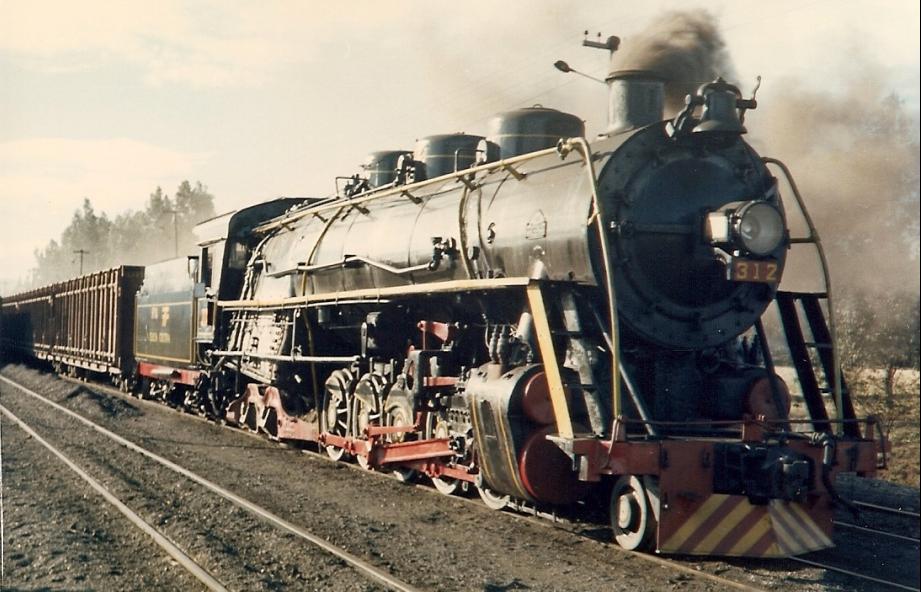

This loco also exploded. Much later though, about 1981.

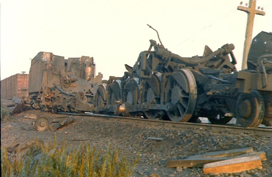

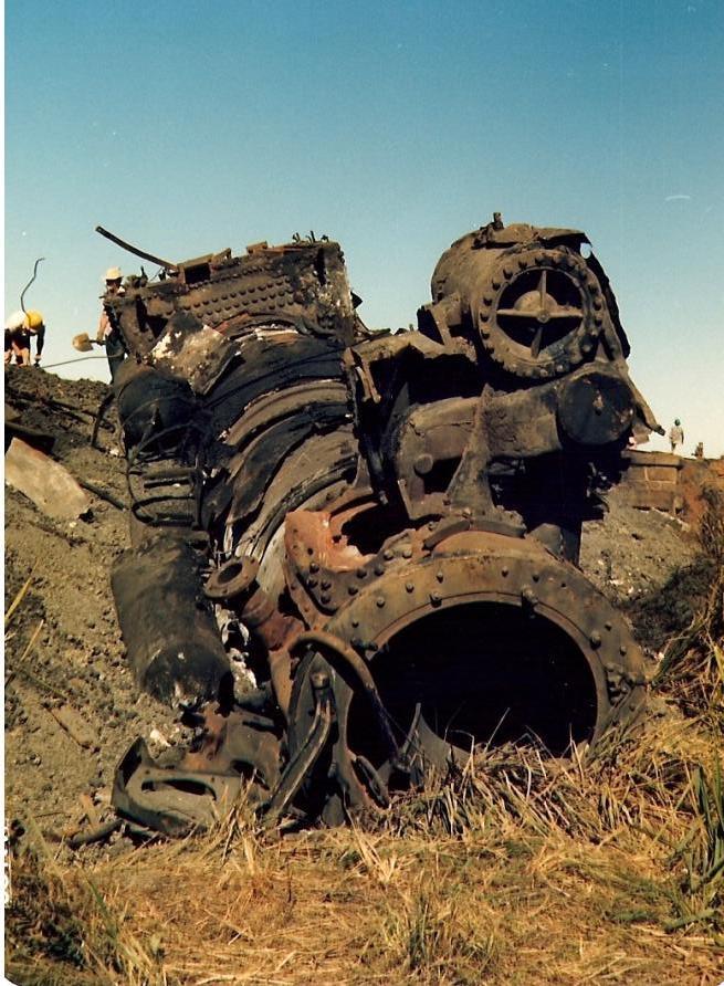

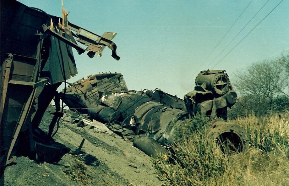

EFDTC Tubarao, Brazil. Baldwin 2-10-4 "Texan" Exploded 15th August 1981

Brazil:
http://www.trainweb.org/tusp/sergio/ter ... stina.html
http://ngdiscussion.net/phorum/read.php?1,219973,220059

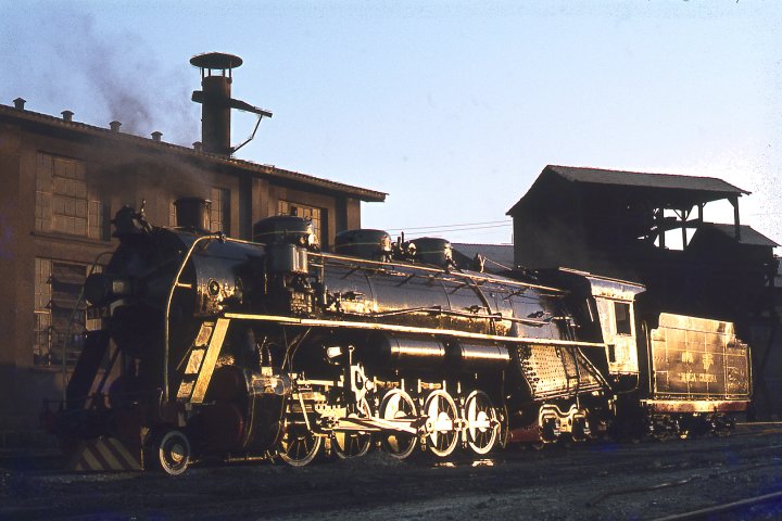

Posts: 347
Same loco just days before.

As a potentially-interesting (for preservation) note: see the discussion on p.786 of the November 1907 issue of 'Power' magazine, where it is noted that failure of lap-riveted seams in iron boilers was notably absent, and a credible reference indicates why this may have been so.

The locomotive in question was a relatively modern (1940's) Baldwin product. No lap seams involved in that one. The photos show the boiler shell intact, so the failure must have been in the firebox. Not unexpected given the age and usage.
My understanding is that NO steam lap seam locomotive boiler has been produced since the early part of the 20th century. Locomotives had outgrown the size and pressure limitations of these boilers by then. Most of the lap seam boilers still in existance are found in steam traction.

As a person who deals with existing lap seam boilers on traction engines, I'd like to temper the "Last straw of confidence" comment concerning lap seams.
We have all read various reports of explosions of all types of boilers for all types of reasons.
I present this lap seam boiler FACT:
The present day traction engines that have their original lap seam boilers have operated for nearly 100 years now, and these boilers are now wearing out from usage and having to be replaced by new boilers. They are worn out from normal wear and tear, not from design problems. Thus, bear in mind that no matter if the design seems solid or faulty, it has survived well over it's designed lifespan.
Yes, there are several original lap seam (and butt strap) traction engine boilers in operation still. These are continually reviewed by owners and inspectors alike, and repairs are done when necessary.
Yes, there could be a lap seam failure tomorrow......or a crown sheet.....or a staybolt.....or a brace.....or a butt strap.....or......
Mark

Here's a couple of interesting notes I made on this incident, from this article.
Firstly, the watchman and fireman noted that the usual practice when putting the boiler on standby for the end of work was to close the bottom guage glass valve "in case the glass broke only steam could escape, and not water". That seems like an open invitation for human error, to me.
Secondly, this account states that there was tearing in the parent material...if the lap was wholly at fault, wouldn't it have just 'unzipped' at the seam?
Mark Jordan, Bruce Babcock and others have devoted considerable resources and effort to finding the dastardly "lap seam crack", and I have too. Lots of failured due to grooving, broken stays, fiddled with srv's, but no lap seam cracks in anything under 40".
To put long story in short form, no one has been able to find an instance of a boiler failure due to a lap steam crack on any internally fired boilers in the last 120-130 years of records. You will also note that these HRT mill boilers were all invariably of the cheapest quality made, most with plain punched holes, with no reaming involved in finishing rivit holes. Plain punching the hole work hardens the metal around it, and leads to the cracking-not the design of the seam. I myself have examined several scrapped longitudenal lap seams on scrapped boilers, not a one had a crack.
The lap seam witch hunt of the turn of the last century was means to cover up poor practices and drive the marginal boilermakers out of business. Since there was no way to visibly verify if an assembled rivited joint had been reamed or drilled to remove work damaged material that would propigate a crack, the simple solution, from the inspection/insurance/engineering point of view was to go to a butt strap joint from the point the supposed problem was discovered. Bluntly, you knew good and well there wasn't a lap seam crack if the thing had a butt strap joint. Most all lap seam failure occured in boilers that had been in service 5-10 years, and any boiler that was going to get one and fail already did a hundred years ago. Just as in Britain before, after plainpunching of rivit holes was discontinued as a practice, so did the cracks due to it.
BTW you can still legally build and use a lap seam boiler in Britain...is the Scepter'd Isle just an amalgam of hot water bombs waiting to go off?
