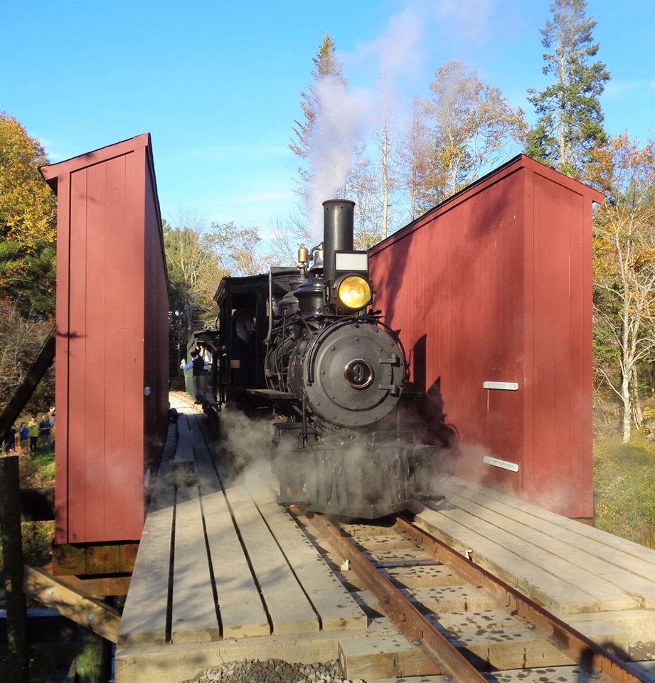

The first trains over Trout Brook in 86 years ran this weekend at the WW&F.
See more at:
https://www.facebook.com/WWFRailway/pos ... 0448401871
Or for those who don't do Facebook:
-Ed Lecuyer

Very sweet photo, Ed!
Congratulations to all hands at the WW&F!
