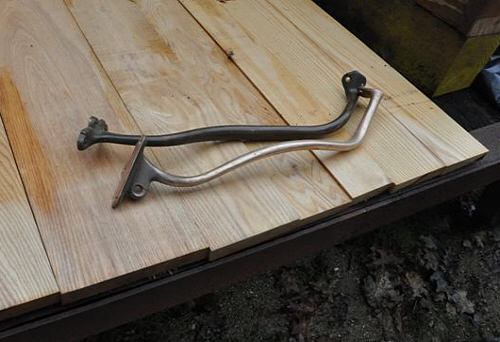

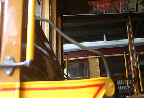

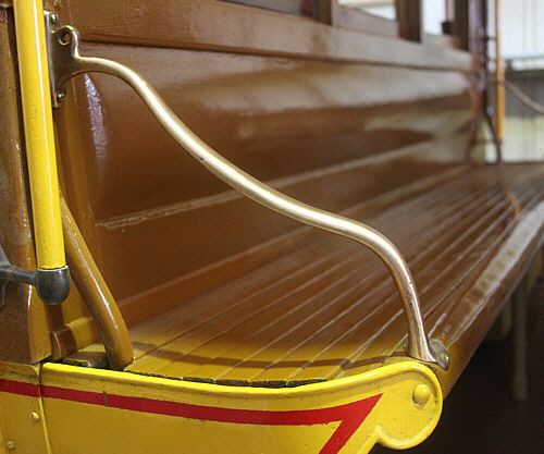

Below are before, during, and after pictures of the seat railings. The middle picture shows the railing before and after soaking in 10% ammonia (janitor strength, not 5% household strength) twice for about five minutes each, scrubbing with a Scotch Brite Pad and wiping with a rag each time. The "after" picture is after polishing with a Scotch Brite wheel and remounting on the car. (See: http://solutions.3m.com/wps/portal/3M/e ... 5CPWS904gl ).

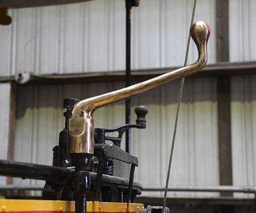

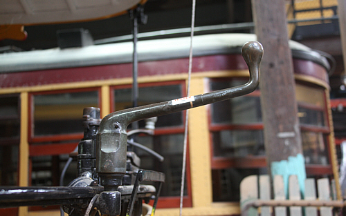

Here are before and after pictures of the brake handle using the same process. The brake handle has a surprising number of dings I might have polished out but it's over 100 years old so I guess dings are OK.
