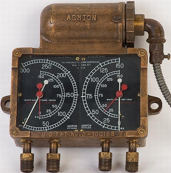

Hi,
TVRM is searching for an Ashton quadruplex stoker gauge for the stoker it is installing on 4501. The only one I've seen is on the C&O 1308, a 2-6-6-2 on display in Huntington West Virginia. If anyone knows of one for sale, swap, or donation, please contact me at steamwhistles@bellsouth.net Our new stoker is a Standard HT model.
Any leads or suggestions will be appreciated.
Tim Gautreaux

Could someone comment on what an Ashton quadruplex stoker gauge does? What does it gauge? It would be interesting to know. How tough is it to find this part and what happens if you don't?
 Post subject: Re: TVRM needs gauge
PostPosted: Wed Sep 19, 2012 11:47 pm
It's a pressure gage, measuring 4 different pressures in one gage housing. Popular form the 1930s on, they are rectangular in shape, have a brass case (some with integral light housing), and four 1/4 MPT connections at the bottom. Essentially two duplex gages in one case with two dial faces and four "hands", they were also made to measure air brake pressures-- brake pipe and equalizing reservoir, and main res and brake cylinder.
The stoker gage measures stoker engine steam pressure and 3 different jet pressures for blowing the coal off the distributor plate.
The quad gages can easily be duplicated by using two duplex gages (still currently available commercially), but the quad gages are much more cool.
Here's what we're searching for.

Could a standard air brake quadraplex gauge be made into the type you need? It's not that hard to have new reproduction faces made.
Mark
