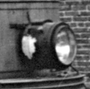

It's not the clearest photo but here is the headlight from Lake Shore Electric 151 after PUCO decreed that headlights must be lowered. Four wood screws and the bracket was lowered. The dark line above the headlight is the grounding wire for the headlight bracket ...wood car ya know so it just goes thru a hole in the dasher.
The two wire headlight cord has a large wood plug with a paint brush like handle that plugs in under the anticlimber. One wire is for bright and the other is for dim ... for the cars running in the dark is was lamp for the city and arc for the country. For the daylight runs it was lamp and lamp.

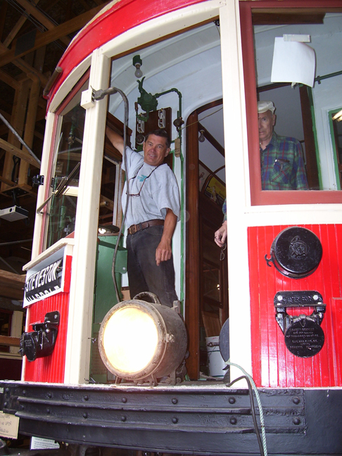

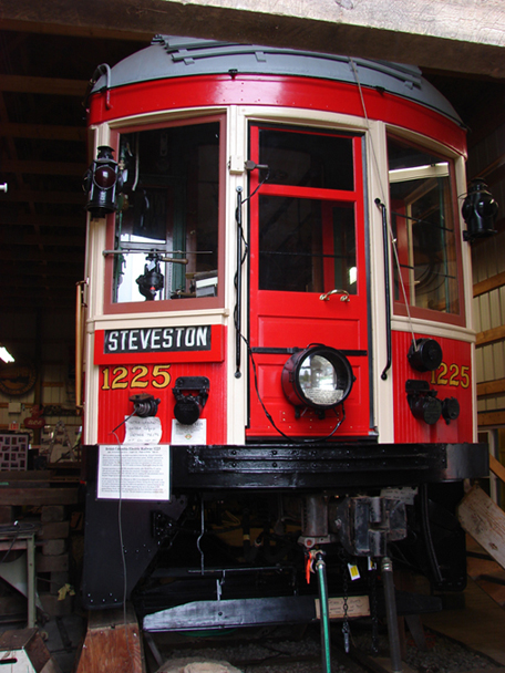

With our car and others that were saved the headlight was removable so as to allow it to be placed on either end door. At the bottom of the light were two adjusting screws to allow for various heights. Notice the "plate" that the screws rest against on the door. The wire leading up to the plug has two prongs. In the other picture the plug is wired to an on/off switch above the motorman's door. As we rebuilt the vestibules our electrician ( 35 yrs with VIA Rail and CN) rewired this "circuit" and tested it. You can almost see the switch if you follow his arm. Works fine as you can notice.
