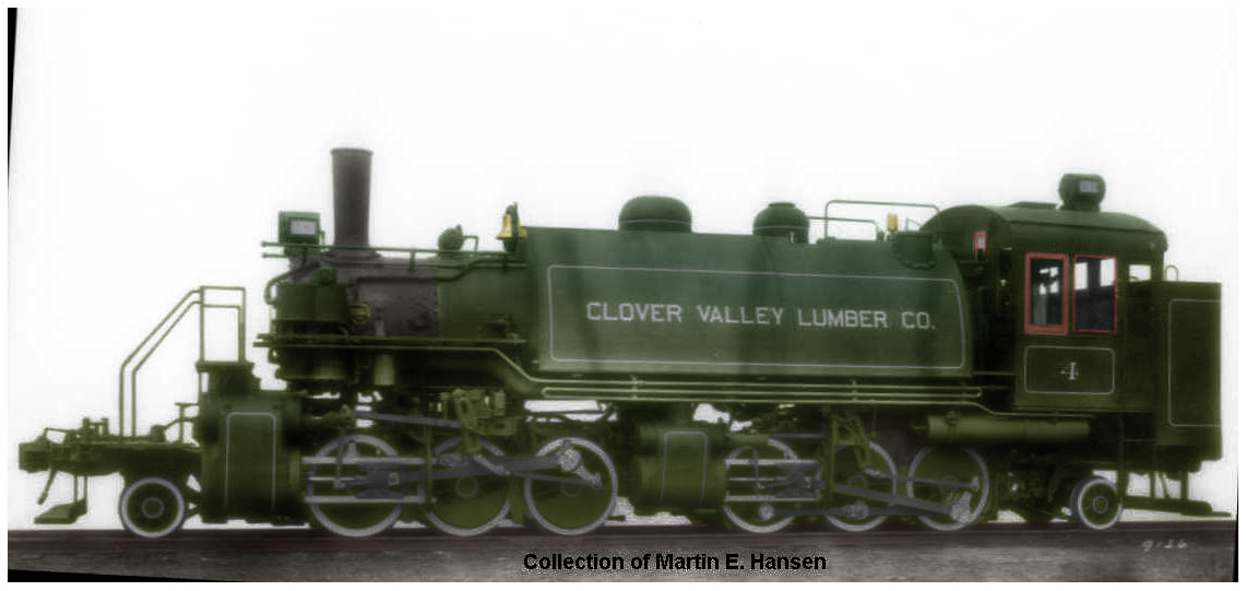

I had no idea that Baldwin kept Olive green as their standard locomotive color so late. It makes sense that most roads would specify Black to keep their roster's uniform appearance, but that smaller lines might not bother.
Tangentially, the Pacific Locomotive Association at Niles Canyon, CA just had their first test run for Clover Valley Lumber Company 2-6-6-2t #4. The Logging Mallets website above inspired me to do this:
File comment: CVLCo 4 Builder's Photo
I do not pretend these color are accurate; my photoshop skills have their limits. Took me a while to figure out that the odd dark zones on the saddle tank were the reflections of cranes over the engine.

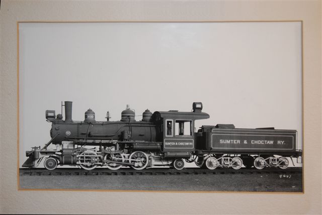

The October 1925 specification for Sumter & Choctaw (Allison Lumber Co.) 103 calls for "Painting Style-Olive Green and Gold". No mention of striping style.
In this builder's photo, the light-colored running gear is obviously just for the picture; helps the shadow detail be more visible. I suspect the darker parts of the locomotive were in the typical flat gray water-based paint to aid the photographer. BLW, Alco and Lima all did that for the "formal" builder's photos.
I would like to see a good match of Baldwin Olive Green to current paints. Awaiting your findings and research!
