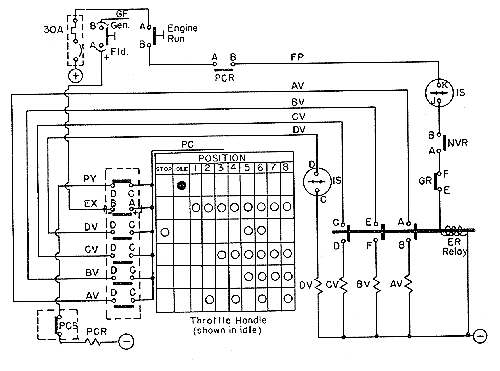

Does anyone know how the control stand communicates with the governor and visa versa (voltage), and what voltage (and is it just binary?) is sent into the 27-pin MU connector to communicate information to the other or multiple units.
Is the auxiliary generator the power for the; control stand, governor, battery charge, and every other; dial, gauge, and circuit (except for the main traction generator and traction motor system)?
I'm wondering how that simple PG governor controls just about everything and how it gets its power and sends feedback to the control stand and how the control stand is powered.
74 volts is the standard operating voltage in most diesel electric locomotives. Simplified diagram is from a GP9 locomotive. AV, BV, CV & DV coils are the speed control solenoids within the governor; AV, BV, CV, & DV switches are the throttle switches in the control stand. There are a few other wires controlling Overiding solenoid and low oil pressure etc. with in the governor that are not shown. Every voltage going to the governor would also go to the MU cable. No feedback to the control stand is necessary in these earlier locomotives. The governor has the ability to back off the excitation if it can not maintain engine RPM via hydraulic lines going to the vane motor of the load regulator, this can also by done electrically via the overiding solenoid. The dot sequence diagram shows what connections are made in what throttle positions.
Some of the other items shown on the diagram:
30A- Control circuit circuit breaker
Gen Fld switch-controls power to the generator field relay, when open, locomotive can not develop power to move.
Engine run switch- controls the power to the governor solenoids via the engine run relay
PCS-pneumatic control switch- function is to open engine run circuit via PCR coil/relay and drop engine speed to idle in the event of a safety related pneumatic event such as deadman foot pedal activation or emergency brake application.
IS-isolation switch-used to take a locomotive offline so it receives no excitation or engine speed signals from the control stand or MU cables
NVR-No Voltage Relay-function is to open engine run circuit and drop engine speed to idle if the power to the engine cooling and traction motor blower circuits fails.
GR-Ground relay-function is to open engine run circuit and drop engine speed to idle in the event of a fault from the traction generator circuit is detected.
PC wire-Positive (+) control wire
Yes, the aux gen supplies the power for control, lighting, and battery charging. Most 1st and 2nd generation EMD road locomotives would also have a D14 companion alternator attached to the front of the main generator to supply AC 3 phase variable voltage and frequency power to the cooling fans and traction motor blower motors ( their speed is directly related to engine RPM).

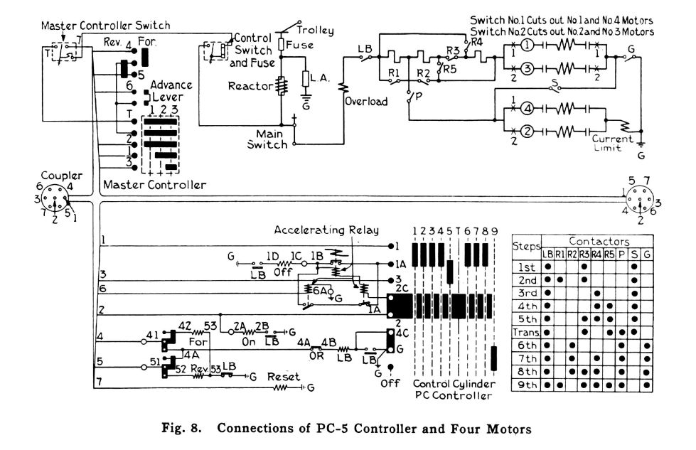

Electric Railways of every mode did not use line voltage for MU control. The control units and controllers used a 32VDC circuit cabled between cars for control. In the cases I am familiar with, dropping resistors were used to achieve this, with no batteries involved.
