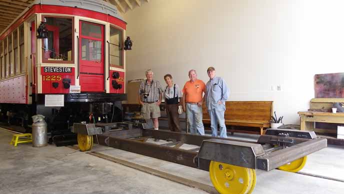

Yes, the FVHRS will be using a towed/pushed generator. The fine folks in Astoria gave us a set of plans for their cart and we had them modified to fit a larger genset. Wheel sets were from Noland.
Attached picture just shows the cart. It will go to Cummins in mid Sept. to have the genset attached. A rectifier will be included to change the AC to DC.
Just today we did a series of tests to see how it would go through switches. Passed. We will do some more once the completed cart returns.
