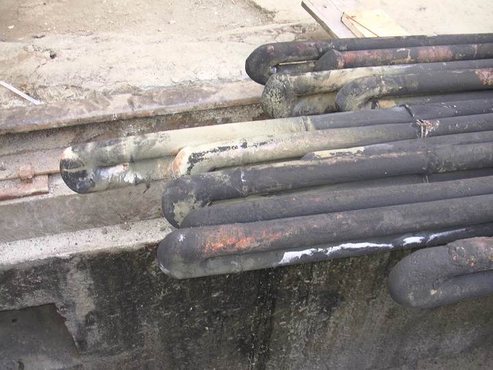

There was a discussion about boiler tubes a month or so ago. Kelly Anderson posted a great ATSF procedure on safe ending boiler tubes. Included in that same procedure were lengths of supeherater units for safe ending as well. As we are currently building new boilers for former G&Q Railway locomotives in Ecuador, we are also in the process of building new superheater units for one locomotive. Included in this thread is a photo of the suphereater units that we removed. The front end of the units are all on the same plane. In other words, they are all even at the neck end. You will notice that the units are all different lengths.
File comment: The neck end of these units are all on the same plane. Notice the difference in length of the individual units. Note also the different types of return bends on each unit.
The longer units shown in the photo have more damage. The return bends are cracked, the piping is damaged and the units are no longer straight. However, the shorter units are in much better condition. Some of these units have been safe ended and shortened. In the other thread mentioned above, comments were made by Mr. Day about shorter superheater units. I have to agree with Mr. Day that there is something to be said about shorter units. The past thread failed to discuss in depth the fact that RR's had procedures for plugging failed units between regular washings and repair. As such, if a locomotive had, say 18 units, but two failed after 22 days of operation, rather than removing the locomotive from service, the railroad may have simply plugged a few units until the next 31 day washing. As such, a locomotive clearly can operate with a certain percentage of units plugged, broken, or damaged. Well, if the designers and the railroads knew that they could run without a certain percentage of units, why then is it that Mr. Day would be incorrect in saying that shorter units may be more effective?

interesting to find different lengths. probably one reason the longer ones experienced the more damage is it is closer to the firebox. That distance could be just enough to produce a higher temperature difference, the longer the tube the hotter the end would be.
But you would sure get a hotter steam from it, but the tube would wear sooner over time. It would also experience more heat differences per inch and you know how rail buckles in hot weather this is mini-sized in the boiler on the tubes on the molecular level. The longer tubes probably need a better sealing with a thicker tube.
You have to note the boiler and tubes have to transfer heat around.
I hadn't heard of plugging off failed superheaters, but now I know how 765 is done, that might be possible without removing them at the time until repairs are possible.

In reading the posts below by Dave i agree, parts cobbled together to keep the engine going. I would venture a guess that the units are so old that the metal is just far gone from any reasonable service life without thought for length or function.

From an old low budget shortline guy: you cut out the worst bits and weld the better stuff together and cross your fingers that it lasts for a bit longer. Hence, we have many different lengths, even taking the multiple rows into consideration. No mystery. No big deal.
Expansion is readily dealt with by the freedom of the elements to move inside the flue. Don't sweat that, on the "molecular level" or even on a practical mechanical level that we might actually want to think about.
There's a bunch of variables involved with superheater element design, steam flow speed and volume at different cutoffs and pressures, heat transfer or lack thereof, surface area for greater or lesser transfer surface.....needing to have enough "cool" steam flow to haul off enough heat to prevent burning the elements themselves........the lag factor during which the superheater element itself needs to warm up to a higher teperature than the interface of the internal steam flow enough to add heat in any meaningful way. Now, when this isn't all that tough to figure out based on a constant flow and pressure, when locomotives don't tend to run at a constant flow and pressure.......you have to solve for all variable conditions within the envelope.
Or, you just make a superheater element that will do a pretty good job and be mostly robust under the most likely conditions of use. That's about state of the art for adequately budgeted applications.
I know John and his crew will build something that is going to be light years better than status quo. I'd welcome further updates outlining the process.

Bob, what we have actually found is that materials are a bigger issue. They do not have an abundance of what would be considered acceptable materials for these units. Rather than cobbeling things together.....they cut things down to keep them in service for lack of quality material.
Notice the return bends. In the photo alone, there are three different styles of return bends (at least). Most of which I believe to be German brands and makes. I have been told that the Germans were the last group of "steam professionals" to work on these boilers and that they brought most of their own material. I can tell you first hand that I question a great amount of the material that has been used.

What are you guys using for return bends these days? 30 years ago, I watched the Fort Wayne guys replacing superheater return bends on elements for 765 with off-the-shelf butt weld steel pipe fittings (90 degree elbows). They'd gas-weld 2 elbows together to make a 180, weld that to the element, and then build up material on the firebox side of the bend to serve as protection against cinder erosion. That seemed to work pretty well.
Are actual forged superheater return bends still available from China or someplace else, or are you using something like this?

The Strasburg return ends work well for me. Personally I would not consider making them up out of fittings or the like. The Strasburg product is spec material, dimensionally accurate, and welds beautifully.

We just bought out all that Strasburg had in return bends and they are making more. So, Hugh, contact Strasburg if you need them......
You would almost think that in an industry as small as ours we would be fierce competitors. The guys at Strasuburg are great and they help us often. In fact, so many of our industry contractors work well together and I am proud that I can call so many of them friends.

At one time, the SLSTA (1522) had a mold with a local foundry and had investment cast type A bends made, which worked great. We had one for Type E units that the NS used, but unfortunately it appears there are more than on size for Type E units. We didn't find this out until we had cast an order for a restoration and they wouldn't work with their units. I still feel bad about that.
When we ceased operation, we sold the tooling. I think Strasburg has the same arrangement of investment cast bends.
I don't know of any forgings still available in this country, but never looked into it.
With the service that most engines see in today's world, I would think that putting shorter units in would be an advantage, particularly in oil burners.
I think those two are different questions.
Can an engine run without a certain percentage of the units? Certainly. Does that mean it's running more effectively? I don't think we have any reason to believe so.
Let's look at the diesel electric world. Can you run with a traction motor cut out? Does that mean it's more efficient?
Shorter units may well be more effective, I'm not disputing that. But I don't think you can prove it using the fact that some engines operated with plugged superheaters.
