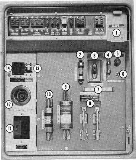

I'd argue that there IS a standard for locomotives, it's just not a "forklift" style connector.
EMD (and I would assume GE and Alco as well), for many years, has used a large, coaxial plug, originally available from Pyle-National. This same connector was also used for battery charging on cabooses and passenger cars.
(see #12 in attached picture for the matching jack, in an SD40-2)
My suggestion would be to use the Pyle style plug if possible, but NOT to attach it directly to the charger. Instead, use either a "twist lock" style connector (as used for 220V extension cords), or a forklift style connector (or the connector of your choice) on the end of the charger cord. You may then make up several "adapters" consisting of the mating connector to your charger cord, a foot or two of wire, and one of the following:
1) the Pyle plug
2) any other connector to match "non standard" charging jacks already installed in your equipment
3) a pair of alligator clips, to accomodate any equipment that does not yet have a charging jack installed (hey, unless you only have ONE locomotive, this project will not happen overnight! )
At IRM we use the system described above, on all 3 of our chargers, utilizing the twist lock style plugs. I believe each of the chargers has 2 cords, and with the "adaptors" removed, there is no exposed "hot" metal for an overly inquisitive visitor to come in contact with, when a cord is "live" but not in use. The forklift style connectors may have openings large enough for little (or big...) fingers to slip in and make contact with "live" connections.
Jeff

The 2 pole receptacle located on the end plates of SR (NS) EMD units is shown as EMD p/n 8176771. Rating is 200 A and application is shown as "battery train-lining."
There are (3) p/n's shown for the plug that would fit into the receptacle shown earlier within the thread:
8062828-Plug 2 pole metal body
8345699-Plug 2 pole phenolic body
8352002-Plug 2 pole rubber body
