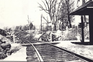

HI
This shot was taken at the Rocky Hill flag stop , in Milford, Mass , photo by Francis Dovavan . This was the type the Boston & Albany used at that time , today the line is a Rail to Trail at this location . Pat.
File comment: B&A Milford, branch , at Rocky Hill
Rocky Hill B&A Milford, branch Milford, Mass-001.jpg [ 29.05 KiB | Viewed 11095 times ]

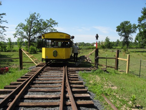

Here is a cattle guard we have in service at our place. It works well on most cattle. (We had one beat us at our own game and got out.)
Erik Thompson
http://www.ironhorsecentral.com
File comment: Cattle guard
