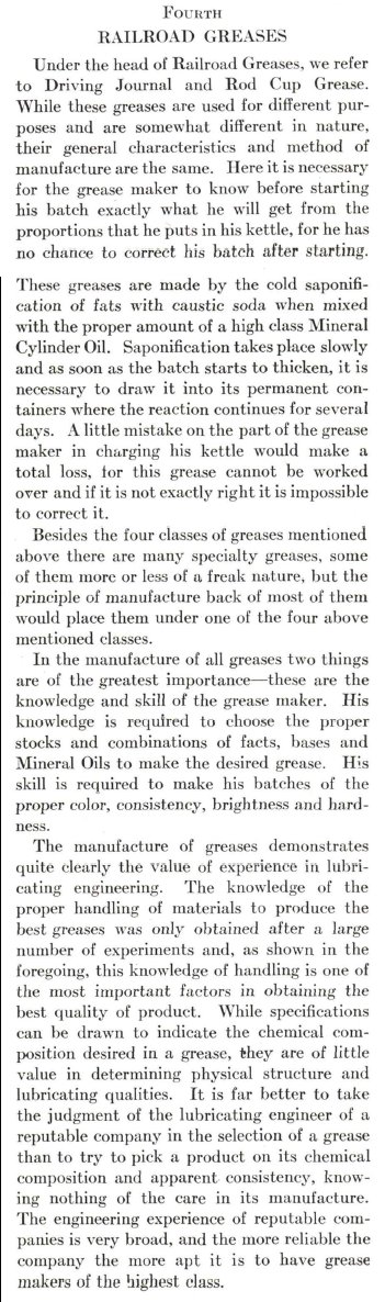

Lost Black Art: Download Texaco Literature

Gentle Hint: this article predates many of the innovations with EP lubricants.
Specifically go back and review the research that led to Texaco M grease.
Then come back here and discuss what you've found.

Well, it was innovative in the Thirties -- and the direct result of even more smoking of main and rod bearings by older kinds of lubricant.
Seriously: I wasn't trying to be snarky. There have been several great changes in tribology since the days when 'facts [sic; read 'fats'], bases, and Mineral Oils' were the constituents of a grease. It's amusing to go back and look at 'expert wisdom' from that era (oddly enough, I was looking at that very issue of 'Lubrication' not two weeks ago!) but if you were trying to determine the correct grease for a modern journal, you sure aren't going to find it via a search on saponification...

From the article posted it is apparent that hard greases for journal lubrication were more closely related to Ivory soap than petroleum products. The soap (sodium hydroxide plus natural oils) provides the solid structure and proper temperature performance while carrying the non-reactive oils that actually provide the lubrication. I suspect that the soap also provided the proper viscosity characteristics neccessary as well. Maybe we should be calling Proctor & Gamble instead of Shell Oil or Texaco!
