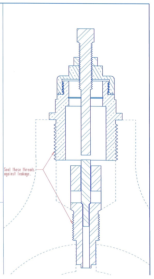

I think Ben isn't thinking about roller bearings in the context of his inquiry, just wanting to know about a source for good hard grease for a traditional split brass big end. Please somebody who knows where to buy the right stuff let us know. He's running short of his NOS supply.
I'm still waiting for more information about the hard greased Garratt big ends. If that was standard practice on some specific railroad, it is markedly unlike that used by every other one I've been able to find out about.
dave
