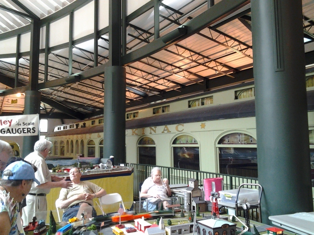

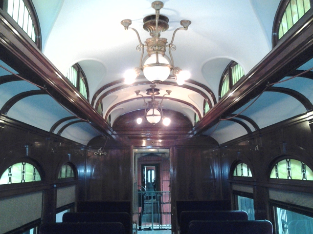

Here is D&M 100 at Carillon Park, last month. Very nicely preserved indoors.
Trivia: she is exhibited with combination gas/electric lamps. Are they original?
Thanks Steve. It's been at least thirty years since I was in Carillon Park, and at that time she was outside, under a pavilion IIRC. Glad to see she is totally inside, although I suppose that explains the lack of photos on the Dayton web site.
Can't tell in the light fixtures are original to the car, but dual lighting systems were common in that period.

The lamps are in the style of Pintsch 4 arm, but of a different design to those seen in the advertising of the time.
May be repros, but the globes hanging off the sides are a giveaway to them being electric now.

Almost that same lamp is shown in the 1906 Car Builder's Dictionary as Fig. 3011, titled "No. 438a Combination Lamp", differing only by having only two sockets for incandescent lamps, but there doesn't appear to be any reason it couldn't have been built with four.
On Edit: I belatedly remember that Google Books has the 1903 Car Builder's Dictionary available on line, and that book contains most the same material as the 1906. Let's see ifthis link will take us to the proper page:
http://books.google.com/books?id=IGVYAAAAYAAJ&lpg=PP9&ots=CQlNF6BfY9&dq=1903%20CAR%20BUILDERS%20DICTIONARY&pg=PA317#v=onepage&q=1903%20CAR%20BUILDERS%20DICTIONARY&f=false
