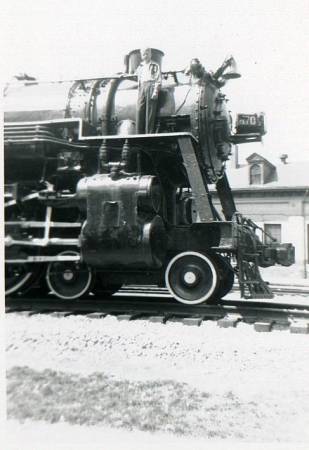

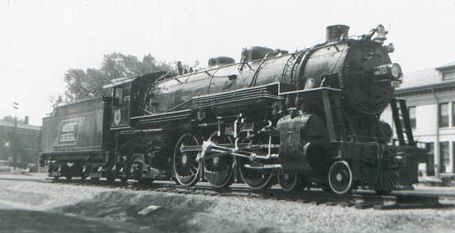

I have an early connection to this locomotive. In the summer of 1954, we were on vacation in New England, and just happened to be be going through Waterville. It must have been just after 470 was put on display. I took the wedge shot and my father took the closeup (for obvious reasons). According to my records it was 7-13-54. I've seen her since, much more bedraggled, but still showing classic lines. I wish her well.

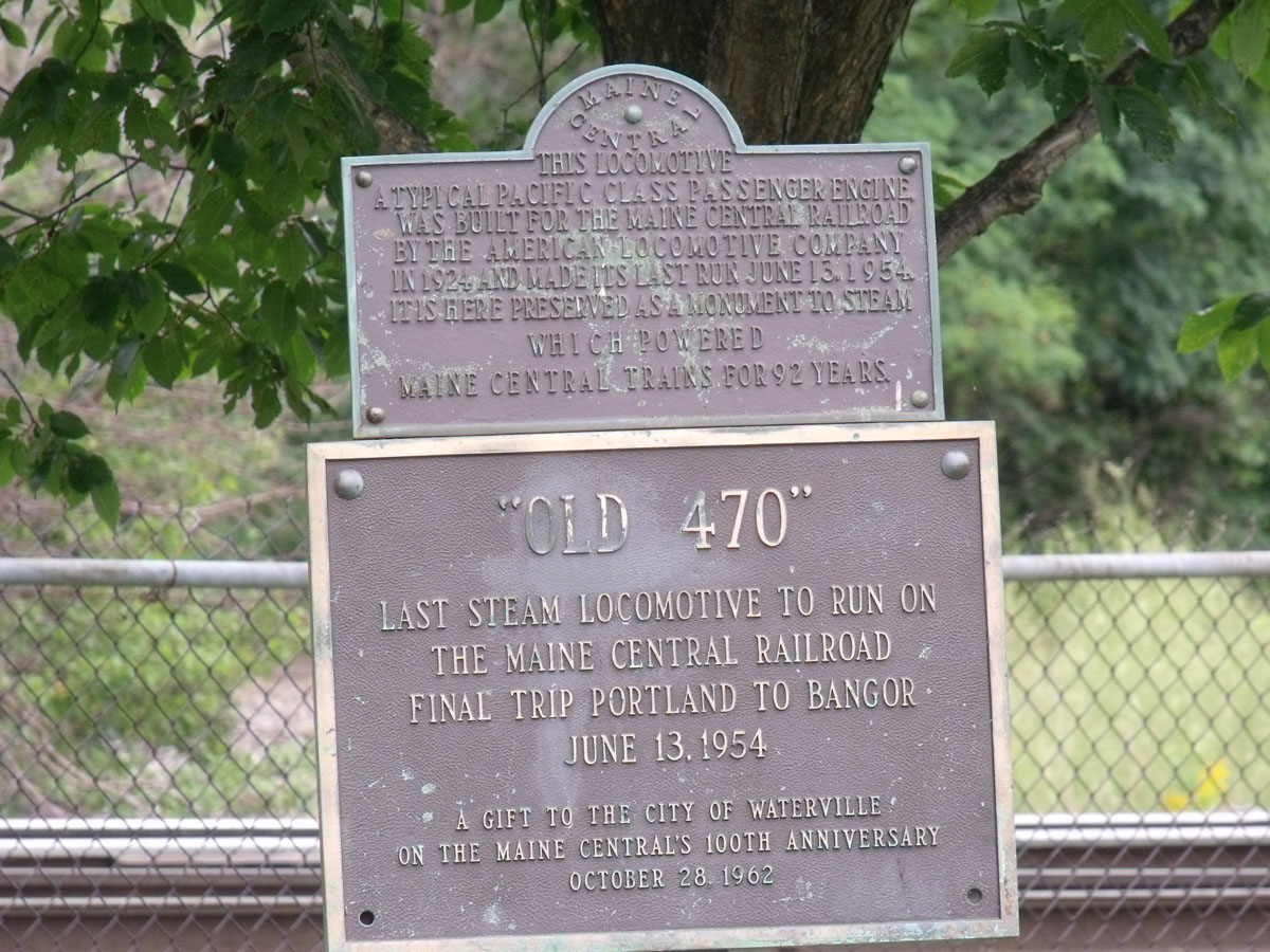

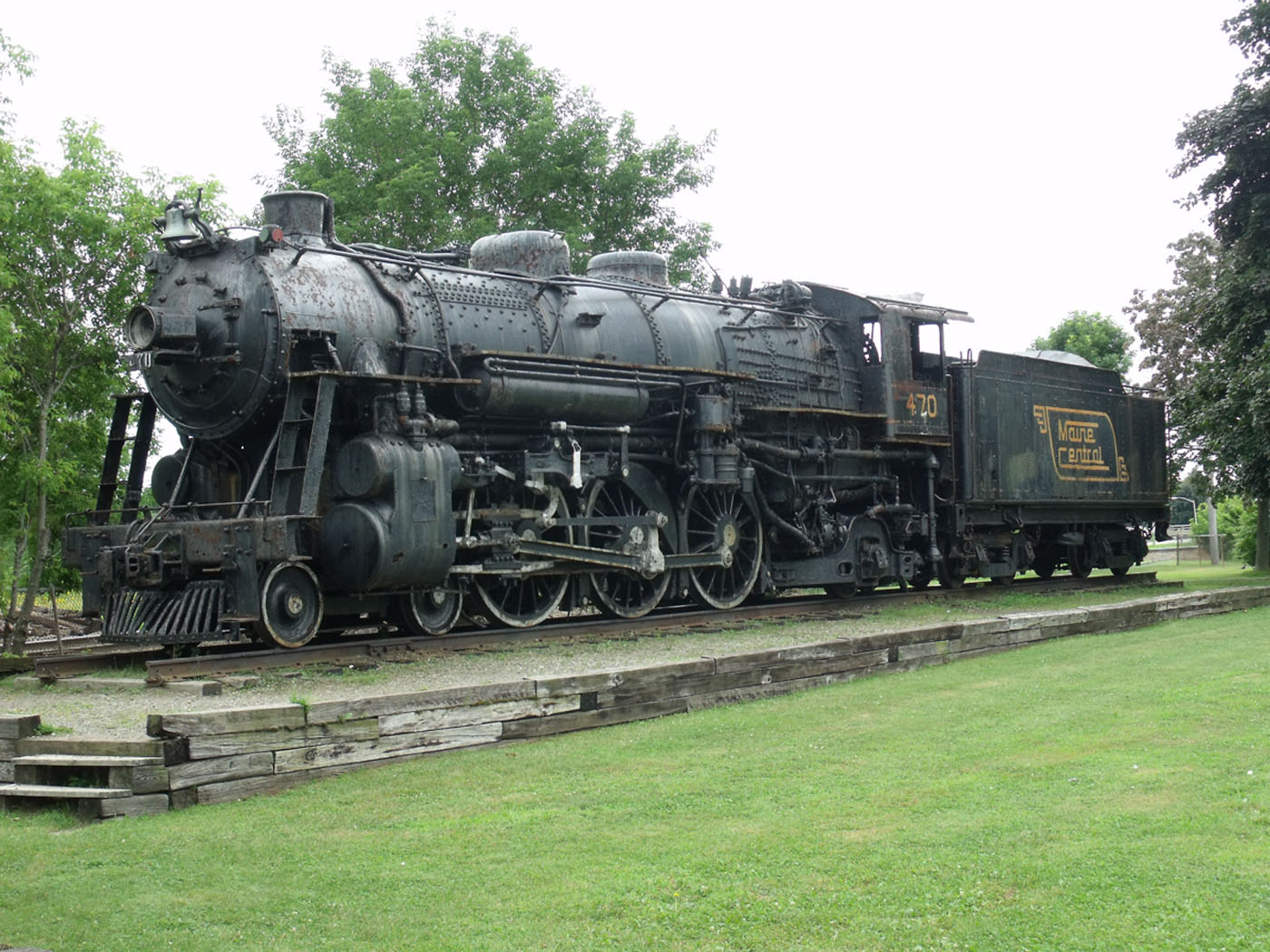

PostPosted: Wed Aug 15, 2012 11:49 pm
Posts: 559
Here are a couple of photos I took while passing through Waterville, Maine on July 17, 2010.
Thanks!
Jim Vaitkunas
