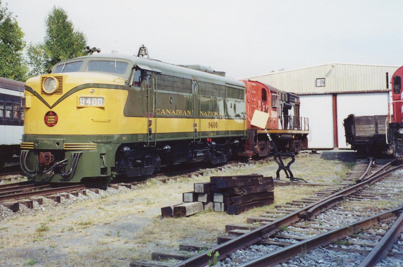

Here is one at the railway museum in Delson Quebec.
