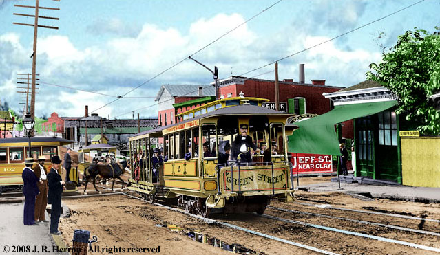

Here's a photo that I colorized of an electrified former mule car in Louisville in the 1890's.
I did this one for our video on the history of Louisville streetcars several years ago. Note that the electric car is pulling a trailer (former mule car).
Louisville preferred mules over horses because they stood up to the weather better and ate less hay.
