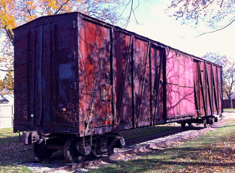

One thing I noticed on a short siding off of the railroad behind a fence near the statue of Thomas Edison, was an old very rusty boxcar. Looked like a 50 footer with outside braces, except steel panels instead of wood. One end had doors. Trucks marked UP. It was explained to me that this is a car that Ford shipped Model T's in. If so, a rare car to be sure. The railroad has some nicely restored freight equipment. Any timeframe on attempting a restoration of this historic boxcar?

Les, the box car you mentioned is a 50' Union Pacific Automobile car. It arrived at Greenfield Village in the late 80s from Stickney, IL via flat car. We tried to find reporting marks, but couldn't find any. There was none visible in the snapshots taken in Illinois when it was sitting outside a power plant. This box car will be worked on at some point. It's definitely a very interesting piece of rolling stock.
 Post subject: Re: Update from the DT&M Roundhouse
PostPosted: Fri Oct 19, 2012 3:25 pm
Those are really interesting cars, very early for all steel cars. also very early for automobile cars of that large size. The design dates to 1915 IIRC, and these cars were written up in both Railway Mechanical Engineer and Railway Review several times.
These car pre-date the Evens style racks by at least a decade, but were set up for double deck loading just the same. Those square forgings you see half way up the side sheets make pockets to hold the ends of wood dunnage that supports the top layer. Somewhere I've been told there exists a photo showing Model T's being loaded in this fashion, with the wheels removed from the top layer, their axle ends resting directly on the dunnage. The wheels to the top layer were packed in around the bottom layer of cars.
At least one group of these cars was equipped with a rail on the cieling to accommodate a rolling hoist for loading engines.
Chris -
Thanks for the photo. I was going through some photos that Mike Pannell referenced on another thread here on RyPN, and found a non-included photo of his of a car that might be a sister to this one. Nice thing is that the lettering appears readable, which might help you guys when you reletter the car after restoration. I am hoping Mike might send the photos of that car which are taken from the other (non-door) end.
