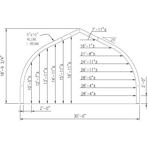

I was saying there's a lot of space on each side before you get sufficient clearance, as you can see in your photo. That building is nearly wide enough for two tracks, but not tall enough.
It's also a slightly different (and better) design than what was originally being discussed, the bracing is on the exterior, and the sidewalls are vertical for a greater distance.
The "Sprung" design has the start of the curve of the wall very near the base, I think it's an integral part of the "sprung" design. To get more height, you go wider. I haven't seem that brand with the vertical sides like in your photo.

Here's the manufacturer's drawing for the Sprung brand structures, which is what was being discussed and also is the most common type.
To reach a clearance of 16' 11", you need to be 12 feet in from the side wall. (A total of 24 feet of width when you count both sides). That is a lot of space...
