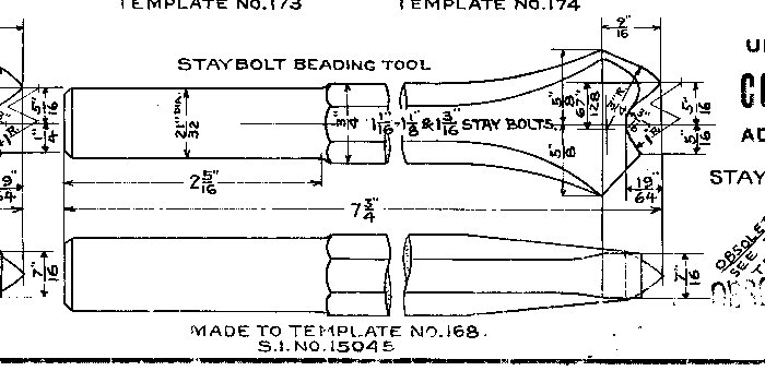

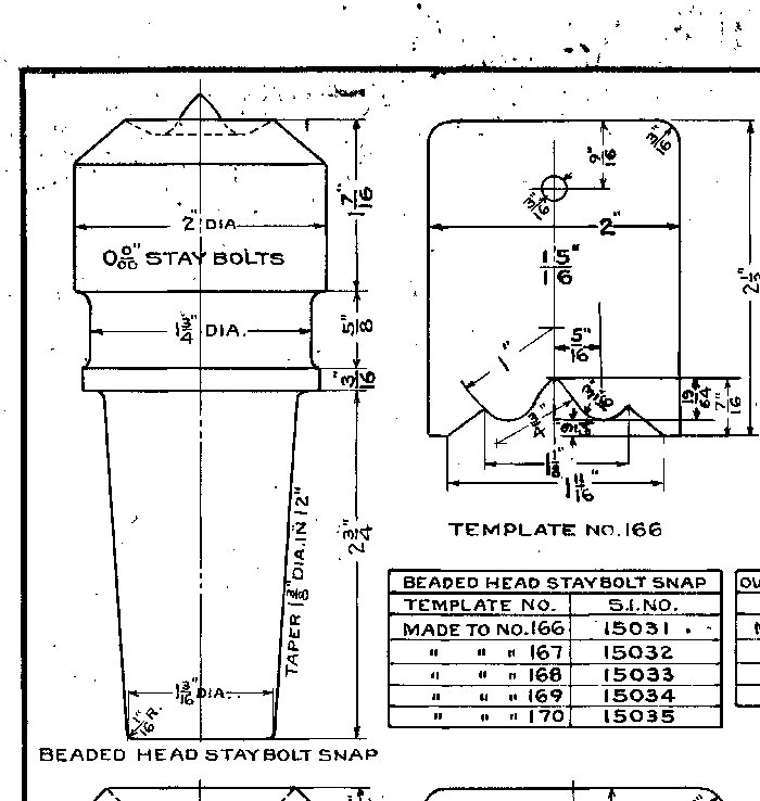

PostPosted: Mon Jun 11, 2012 2:31 am
Posts: 489
Print for UP staybolt snaps and beading tools.(264 views, only 10 downloads)Image

I am curious, do you feel these tools will/would work as well on current staybolt materials as they did on older wrought iron bolt stock?

 Post subject: Re: Wallstay rotary snap tool
PostPosted: Tue Jun 12, 2012 5:26 pm
Joined: Tue Sep 13, 2005 9:54 pm
Posts: 107
I had some orginial beaded head staybolt snaps which I tried with a 60 hammer on steel staybolts and I could not drive a head on the bolt. The head of the snap are like the drawing on this thread. I would guess the worked well with the soft Iron staybolts in common use during the steam era.
