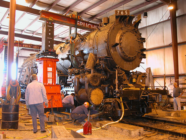

We've put nearly 300 photos online from the 765's 2000-2005 rebuilding. While many are technical in detail, there may be some interest: http://fortwaynerailroad.org/rebuilding-the-765/
For a refresher, the rebuild of Nickel Plate Road steam locomotive no. 765 took place over five years from 2000-2005, consumed over 15,000 volunteer hours, and cost $750,000. We estimate today we've spent about 1.8 million since 2000 on the locomotive, including latter day upgrades like tender rollerbearings and cab signals: http://fortwaynerailroad.org/more-21st-century-upgrades
The original restoration of 1974-1979 had carried the 765 through thirteen years of passenger excursion service, but by 1993 the 765's running gear had accumulated over 115,000 miles, having last been overhauled by the Nickel Plate Road in the late 1950s.
During the course of the rebuild, the original blueprints were consulted to assist in returning the locomotive to as built condition. Along with our volunteers, steam contractors Gary Bensman, Robert Franzen, John Rimmasch, Mark Ray and others at TVRM, Scott Lindsay and Steam Operations Corp, and many other friends in the industry were also heavily involved in the work.
We're still organizing and dating these photos, so some may appear out of order.
