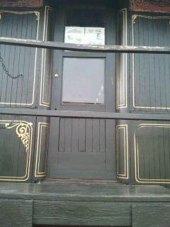

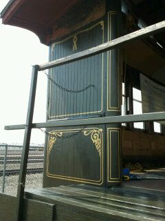

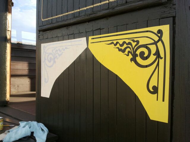

Spent the last few days (when it was cool enough to even apply paint) masking and applying the gold decoration to the cars east end.

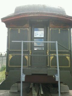

This illustrates where the design came from, the c1900 photograph at Pullman's factory.

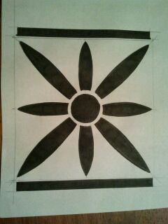

I traced the design we found under the hood on each end and transferred it to clear film. The design was adapted to achieve the curved panel lines as per the 1900 photograph. This was then sent to High Res Imaging of Pueblo CO and made into disposable vinyl masks which were pressed on and peeled off once painting was complete. I used the amazing One Shot gold signwriters enamel which after two coats looks amazing. Evidence of the lining on the door and corner posts was found on the car as well. The designs with rope like tassels were drawn by hand round a home made card stencil. The flowers on the corners were hand drawn and are being made as masks right now.

Note of course the deliberate error of the masks being put on the car the wrong way up !
It got rectified.
Mike

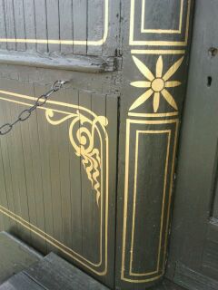

Applied the new flower masks today so apart from the doors the East end is almost complete with its gold finery.
