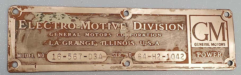

I have a similar question about a tag I have. It was removed from a marine engine I worked with and was de-turboed at some point and had Roots Blowers and this tag was still fixed to the right bank of the block. This vessel has been scrapped so I decided to save the tag.
Can someone explain the serial number to me. I have read below and and unless I missed it, I did not see some parts that related to the tag I have. The serial number is 64-H2-1042.
Thank you all in advance.
 Post subject: Re: EMD engine block serial numbers
PostPosted: Thu Mar 14, 2024 4:05 pm
The same "decoding" as explained in the second post should apply for this part-- 1964, month "H" is October, 1042 is the sequence number.

Thank you Howard P,
Went back and read again and it makes sense. Much appreciated. Wish I had known Preston. I did correspond with Jack Wheelihan at times and he too was very helpful. Lost touch with him in the late 1990s.
Thanks again.
Robert

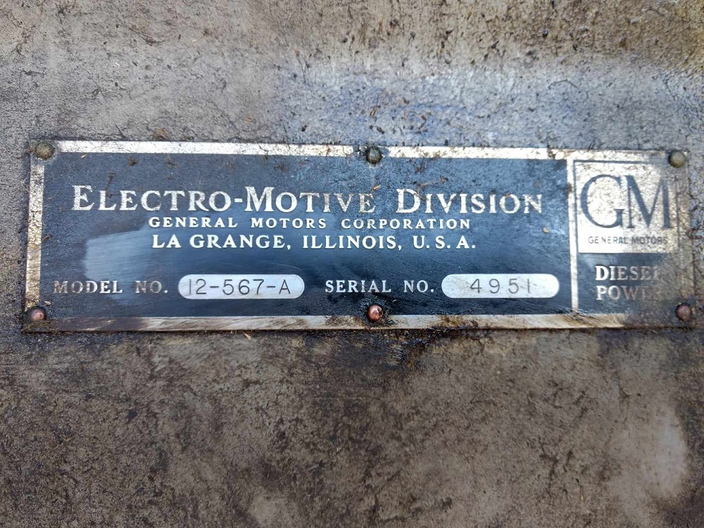

For the older engines with straight serial numbers, were they all just numbered sequentially or is there a code to the number form?
This one is from CN 7944, a NW2 built in 1946 that is now preserved at the Alberta Railway Museum. One of the few Canadian EMDs that came from La Grange (or perhaps Cleveland), since the London plant hadn't opened yet.
