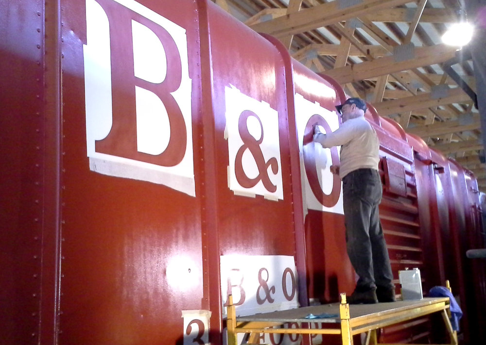

While the warm fall weather has been holding the IRM freight dpt. has been busy finishing up our B&O Wagon top box car project. This has been a very long stop and go restoration, interrupted over the years by more pressing projects.
Victor Humphries seen here doing decal prep work has been the force behind finally finishing the car. Sandblasted, primed and almost repainted for a failed movie project in 1991 we had the proper repairs completed and repainting going again now that inside storage is secured.
Many thanks to the donors who have generously given to the project, as well as The B&O Historical Society for the help and graphics downloads available.
Interesting history for this car reads like George Washington’s hatchet. The original wood car, built in 1912, had it’s top rebuilt in 1937 into a steel wagontop car. Rebuilt again in 1955 the frame was replaced, so nothing of the original remains.
Of 1,240 built only three others that we know of remain, ours the only M-15 as well as the only wagontop boxcar known to operate.
File comment: Victor applying masking

Looks great so far. Curious question - will/did you spray or brush the white? While brushing would likely be more authentic, given the not-so-pristine surface of an old car, I'd think spraying would give a better result with less bleed under the stencil.

Going for the 1955 rebuild look I assumed a stencil of some kind was used. We used low stick vinyl masking cut to our graphics. Then used a small foam roller to put on primer and two coats of white gloss enamel.
As the car is pitted from rust we had some trouble getting the vinyl or painters tape to stick when it turned colder (below 60F).

One trick, if you can stand the wait for another drying cycle, is to paint a coat of the background color, in this case the car color, as the first coat in the stencil. The result is that coat seals the stencil, and any bleed under matches the background, yielding a sharp image.

That technique works well with some paints and I'd recommend a test first as it can be tricky. With a full cure after sealing the edges, you might have a heck of a time removing the stencil (been there). If your paint develops a dry film before it's cured and you're able to put another coat over top without bleed-through, the stencil should come off much easier but be careful not to lift the edge of the semi-cured base coat with it (been there, too). This is much easier with automotive paints that aren't a high build but still not as easy as with model paints. Your mileage may vary.
My preference would be to spray and touch-up by hand if necessary.

Pulled the stencils from one side and took another poor picture with my phone. We are happy with the results. Only the most pitted areas had some paint creep under the vinyl.
