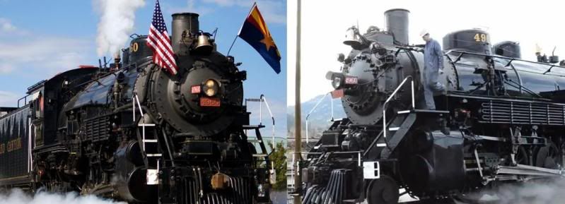

Here's a comparison of the old (left) and new (right) stacks.
Photo on the left is from the GCRY's webpage; photo on the right is a screen cap from the video linked at the top of this thread.
It's definitely a cosmetic improvement, but it appears to be the same dimensions as the orginal "liner" that Nigel designed. Their Facebook page has quite a few detail photos of the inside of the smokebox with clear shots of the Lempor nozzles. The removal of the original stack with liner is shown in one of the photos.

 Post subject: Re: 4960 test run!
PostPosted: Mon Feb 13, 2012 12:55 pm
Joined: Fri Nov 16, 2007 10:21 pm
Posts: 178
Hugh is correct. Because of the stack modifications over the years, we needed a cutting torch to remove the stack in order to facilitate removal of the superheaters.
Instead of welding it back as it was, we decided to make a few modifications. The old stack (outer sleeve) was removed entirely, and the inner lempor liner was fastened directly to the flange that bolts to the top of the smokebox. So while the appearance is much cleaner looking, the functionality has remained unchanged.
