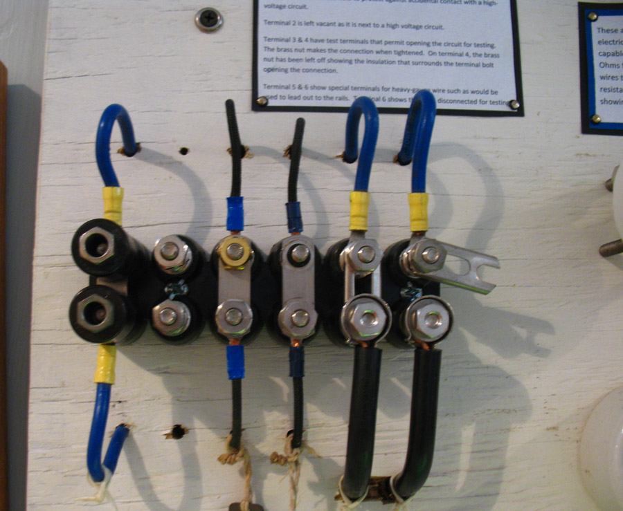

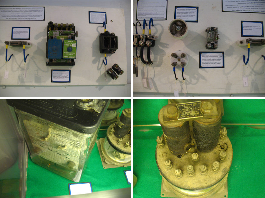

Monticello (Illinois) has a nice display.
Steve

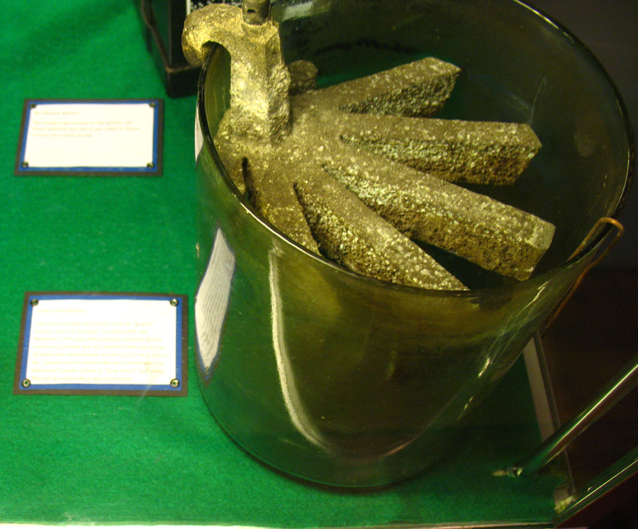

Steve, Your last picture shown of the display at Monticello Illinois i find interesting and thank's for posting those photo's! This is why i like the RPN website as i find it very informative with the many post's and photo's shown that one can learn from.I have a question about that lead 7 finger looking pc. that is clipped on to the side of the glass battery jar.I'm guessing that this is some kind of lead plate?
The reason i'm asking is 10 years ago i found 3-4 of those lead pcs. just like it laying in the attic of a local railroad depot that was going to be demolished.They weren't far from a wooden rack with threaded pegs that had once held early glass insulators wich were broken and strewn about and the telegraph bay window room was underneath below.In the attic there were still many iron ramshorn insulators screwed into the rafters and beams wich i rescued but i don't recall seeing any intact or broken glass battery jars.I picked up those 7 finger looking lead pcs. and still have them and never knew what exactly they were and everyone i had ever asked had no idea as to what exactly they were.
I have seen the round and rectangular glass battery jars with the white porcelain Edison lids before in old abandoned battery wells along the Erie RR in Ohio wich always intrigued me but those had the large flat lead plates inside.Most battery wells they were in were full of water due to the metal access covers missing or thrown off to the side.The few wells that were dry inside wich still had intact batteries on shelves inside wich were no longer hooked up or used had no ladder to get down inside and the ones that had a ladder to get inside the jars were alway's busted.
These other lead type plates the 7 finger looking ones if that's what they are in your last picture? Are these a more earlier type used from the 1870's -80's? The depot i found them in was built in 1880.Why didn't the battery jar in your last photo have some type of lid? Looks like a pretty interesting display that they have at Monticello.

The captions in my photos are too overexposed to read but with a lot of enhancement I was able to come up with this for the crow's foot cell (accuracy not guaranteed):
Crow's Foot Battery
This is an example of a Crow's Foot or "gravity" battery and is a "primary" or exhaustible cell. Batteries of this type were used at locations where commercial power was not available and one or two of these cells would power a track circuit for a year or so. Copper and zinc electrodes were immersed in a mixture of copper sulfate or "blue vitriol" and water. This cell would produce about one volt.

In ionic chemistry there is acid and base (alkaline). Both are workable electrolytes, they do conduct electricity and are chemically reactive. Many types of cells use alkaline electrolytes. For instance the Edison secondary battery used potassium hydroxide (KOH) with a small amount of lithium hydroxide (LiOH) to help performance.
The problem is, lithium hydroxide will very aggressively react with atmospheric CO2 to form lithium carbonate (Li2CO3). This hurts battery performance, not least because it deprives the battery of LiOH. The only curative is to change electrolyte. Battery oil is used as a vapor barrier to keep atmospheric CO2 out of contact with the electrolyte.
Oh. And here's your crow's foot battery. http://w1tp.com/mbatt.htm

Robert, Thank you for the link on the Crowsfoot battery.I found it very interesting and i appreciate everyones post's explaining these old batteries.My knowledge of chemistry,batteries and the relay parts that make a RR signal function is not good.
I didn't know that the battery plates/crowsfoot electrodes were made of zinc as i had assumed when finding the old discarded ones and picking them up that they were lead as they looked and felt heavy like lead.Over the years i've found many of those small Edison battery oil bottles along RR row's at locatons where signals and battery boxes once were as the signal maintainers tossed them into the ditches nearby.I alway's thought the little bottles were rather neat having Thomas Edison's signature embossed in the glass.
