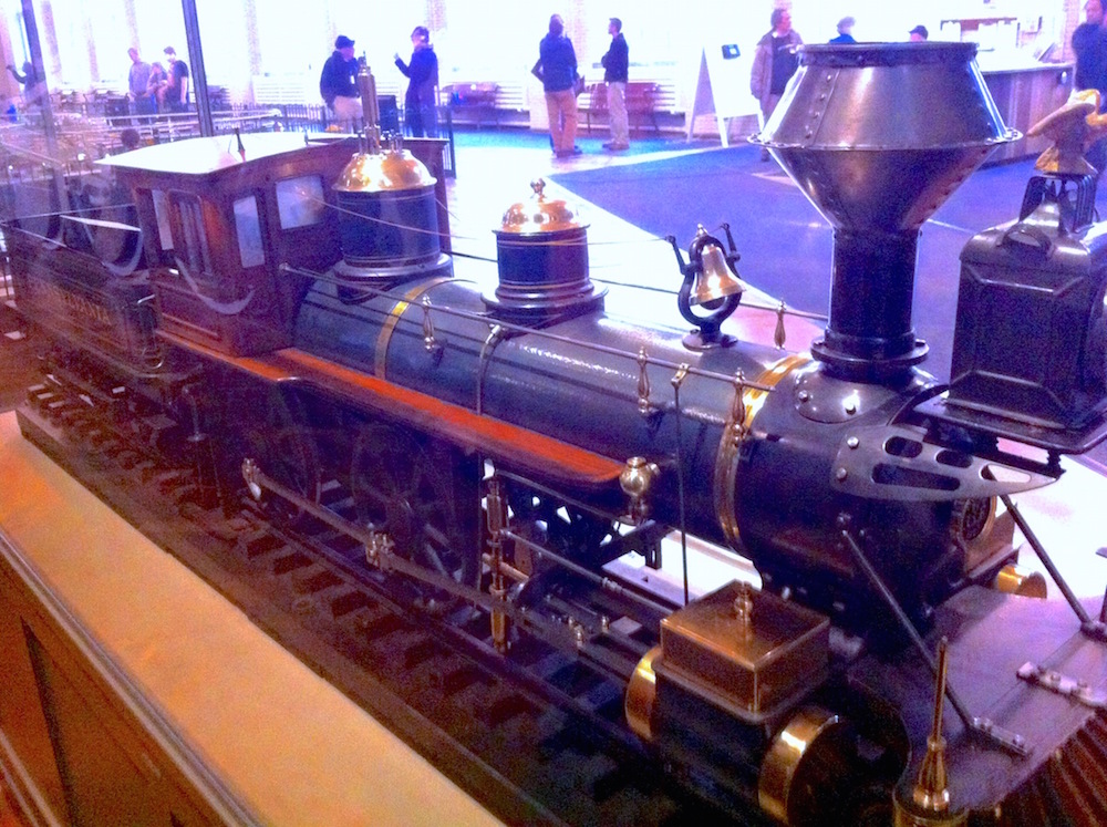

A live steam model of a Pennsylvania 4-4-0 at the Henry Ford Museum has a true Russia Iron jacket.

The defining feature of Russian iron was the coating. This was a thick carbon based coating that would resist rust if kept oiled. It was highly reflective, almost enamel like. I had a piece inspected by a physicist who told me it was an "interference coating" defined by her as "reflecting one wave length of light" to explain why it looked like it did.
There was a similar product, called American iron, a copy of Russia iron, identifiable because it was made with rollers and lacks the planishing or hammer marks that Russian iron has. By the 1880’s American iron was much more common, and Baldwin was calling the product “planished iron” on specification sheets.
While there are rumors that the Russians made a run of Russian iron after WWII to restore the Hermatage (it was roofed with Russian iron) no other preservation project has reproduced or tried to reproduce it, instead using a paint or “pickle” coating that looked like Russian iron. Some have tried gun bluing to replicate the appearance, but it doesn’t have the thickness or reflectivity. The jackets on the locomotives at CSRM, NSRM as well as on Eureka are all painted coatings on plain iron jackets. Chris DeWitt (NSRM) would be the expert on these (paint) coatings.
There is something of a debate about what color it was… with lots of people saying blue (it wasn't blue). All the samples I have seen have been a medium dark grey… Supposedly export controls included screening for color. Be careful to question the information you get. This is a subject with more bad information than good. Modelers have polluted the information pool.
Unless you are trying to recreate the “real” coating, the composition of the iron/steel sheet isn’t that important (to the appearance, but stainless steel lasts better as a metal boiler jacket.) and if you are trying to replicate it the sheet iron is according to traditional stories very important. Simply using old style iron isn’t specific enough.

I'd expect it to be medium to dark gray, possibly with slight mottling of the color, with an iridescent sheen (perhaps similar to oil on water) depending on how the light hits it.
It is not likely to be 'blue'. Blue (well, heat blue) is an interference coating of oxide (I believe this is the same 'magnetite' that forms the protective layer in boilers, Fe2O3) that is built up by heat; it is a conversion of the metal surface itself, and not something that depends on added carbon. I am familiar with this from watchmaking (where I use a tray of silver sand over a burner to get the desired even heat and lack of oil or air-blocking contact that is needed for a good blue). There are tables that correlate the color to the temperature of the part - I am personally fond of the 'purple' that was used on the hands of some good Illinois railroad watches. Bluing large sheets probably requires a controlled temperature and rapid cessation of heating when the desired oxide color has been achieved.
There are chemical (wet and fume) bluing processes that build up similar layers; there is also case-hardening/nitriding (which puts elements into the surface of the metal, effectively 'prestressing' it). This produces colors but not usually in a single or consistent color.
Cold bluing isn't the same thing as either of these, and in my opinion is a very poor substitute. (Don't get me started on Parkerizing, or phosphate surface finishes!)
