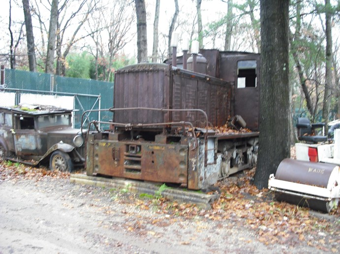

If you are indeed talking a WE, then it’s a rare gas electric using Westnghouse electrics. Six were built back in the 1930 time frame. Of the two I have seen firsthand, they had outside frames. Based on the needed length of axles beyond the wheel at 3’ gauge, I would see this as a poor choice to regauge.
If its an ML, then its mechanical and potentially has the wheels on the outside of the frame. This might be a candidate to regauge to 3’ gauge. An outside frame standard gauge ML looks like a rare combo.
To confuse things further, the Lakehurst Plymouth, c/n 3668, is a WE-2 built on an ML frame. It uses Westinghouse electrics with a LeRoi six cylinder gas engine.
J.R. May
