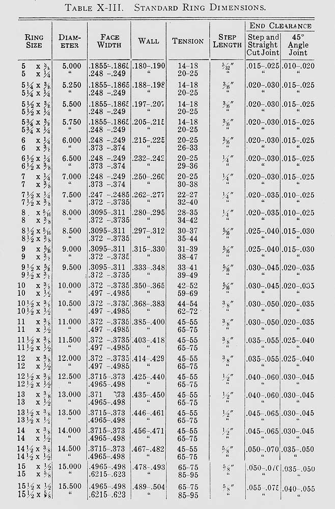

Not sure just how helpful this is without knowing just what the useful compression rate PSI is, however, the value in diesel practice is given as between 5 and 20 PSI - which is a pretty wide berth if you ask me. I guess it sort of depends on whether Martyn's "diesel quality" refers to all characteristics or just what kind of metal.
This is followed by a table of standard ring dimension for rings between 5" and 15.5" diameter. I'lls can it and post it when I can.

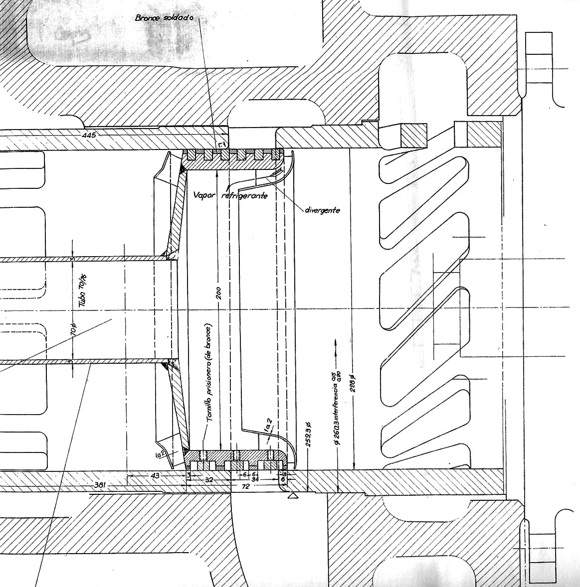

Valves, rings, tribology and all that stuff is far from my area of expertise I'm afraid. However this drawing has very recently come my way. It shows a Porta type lightweight, articulated mutli ringed piston valve. It doesn't necessarily relate to the very latest thinking on valves; I am uncertain of the date of the drawing but it is advanced compared to just about everything else. It also doesn't provide all the info you are after but it may be a start?
Martyn.

Martyn! Welcome......and thanks. Thanks also for your web posting of a lot of very interesting international information.
Looks maybe like a refrigerant compressor valve but my limited Spanish is mostly obsceneties in Cuban dialect picked up in the '60's in Miami. I'm sure others can translate much better.
The bronze lands and narrow grooves do look a lot like what Porta and Wardale were suggesting and using in their experimentation.

I think that is simply "Cooling Steam" because an auxiliary passage sweeps cool exhaust steam over the back of the rings. It is interesting that admission is not a ring controlled event. It is my recollection that Mr. Porta advocated for admission to be ring controlled and exhaust piston controlled (softer.)
Some of the larger bore stationary steam engines I work on have fairly narrow rings for their size. A 1" x 1 1/4" x 45+" OD ring can barely put tension on a cylinder wall.
There is always an issue of practicality, too. Very small narrow rings are easily damaged from corrosion due to poor layup or loss of lubrication, The smallest engines I work on often have labyrinth groove valves for this reason.
I think the basic lesson from Mr. Porta is to use a plurality of rings (redundancy) for a purpose with the minimum number of joints (leak paths), and make sure they are flexible enough to seal despite cylinder irregularities.

You are correct, Matt - if you look at the valves in Red Devil, you will see the outermost lands on either side of the distal admission and exhaust rings are very narrow, stop just inside of the rings circumference, and gracefully widen in a sweeping aerodynamic curve down to the hollow valve body on the admission sides, and widen but less gracefully at the exhaust sides. The edge of the ring controls the opening.
Wardale also makes a point of the lubrication happening in the valve liners in a location that will be swept by the rings but not ever open to the exhaust passage. This practically means two oil feeds, one for each end. I think he stayed with one for the cylinder........I'm rereading Red Devil now, and it is densely packed with information and makes for a slow go.
For our purposes, I'd want to make the valve and piston rings sacrificial to preserve the integrity of the bores. Rings are easy to change; boring and sleeving not so much as indicated on the other thread about it.

OK, here's the table of stock ring sizes specifications by diameter of bore I promised.
