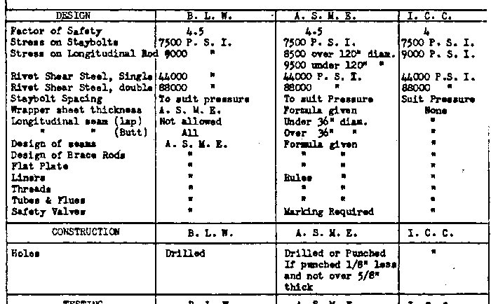

SANTA FE 2900 BOILERS WERE MANUFACTURED USING CARBON STEEL
PER BLW STANDARD PRACTICE, ALL HOLES IN BOILERS WERE DRILLED

Good point Matt. We're mixing up Santa Fe 4-8-4 classes.
IIRC the 2900's were built during WWII when the alloy steel wasn't available (at least not for locomotive boilers) requiring the use of thicker carbon steel for the boilers resulting in them being the heaviest 4-8-4's ever. This was a blessing in disguise as they avoided the boiler problems that afflicted the earlier 4-8-4's equipped with alloy steel boilers.
