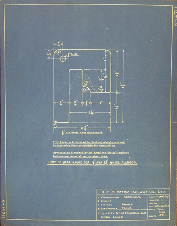

For those in the interurban area and are interested in a possible wheel measuring tool
attached is a blueprint that may be of some use?
File comment: City and interurban Car Wheel Gauge
