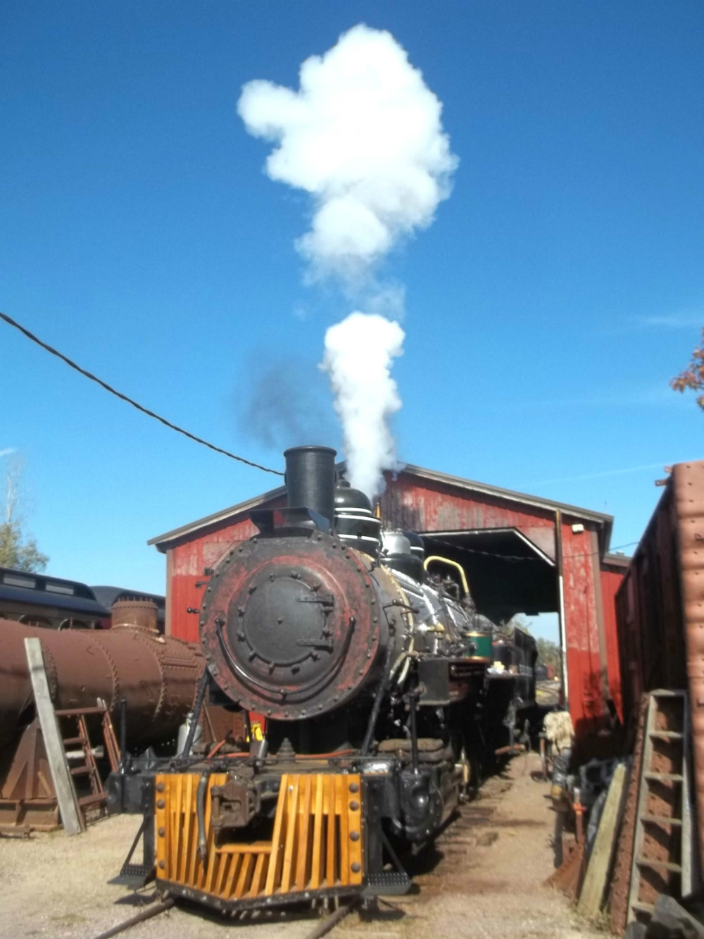

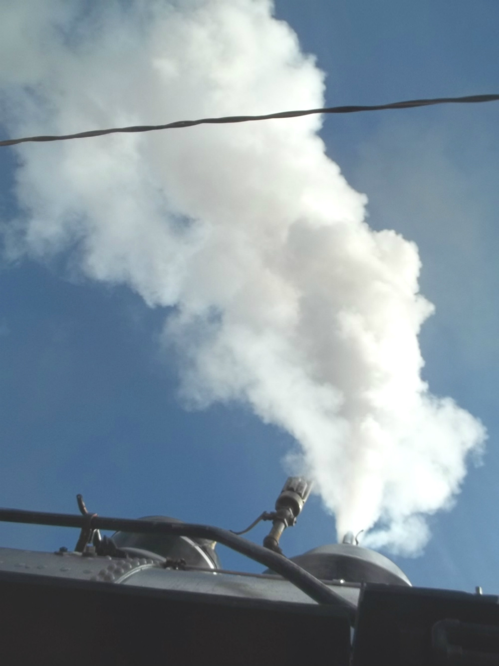

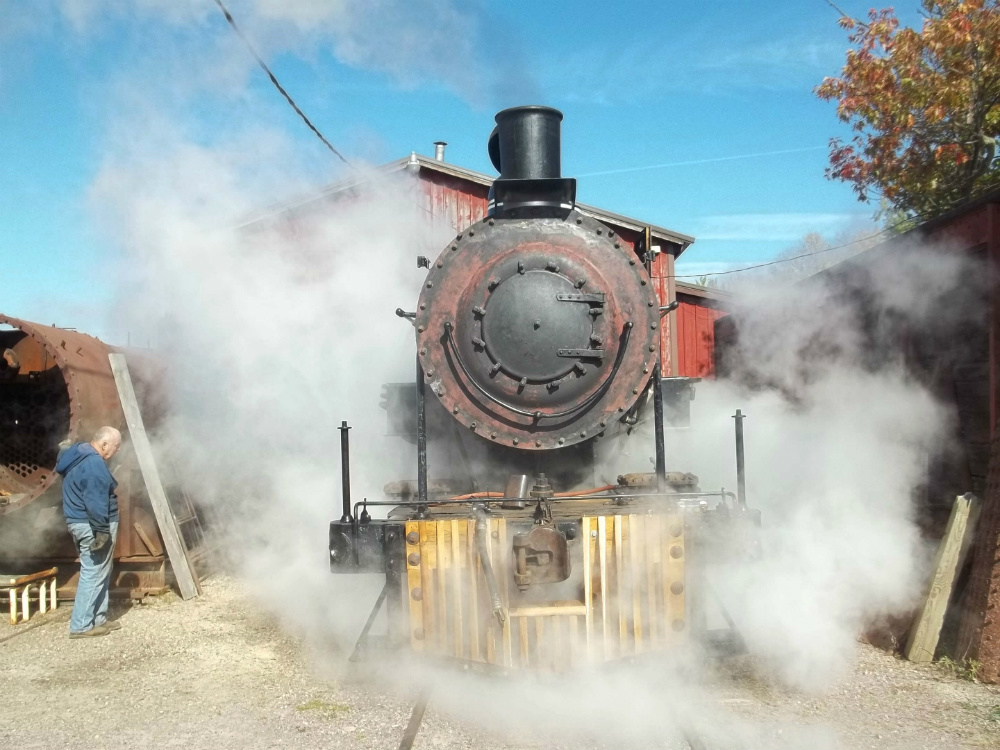

Sunday A.M. saw the pop lifting, steam passages blown out (Skip watching), and more whistling to passing museum trains. It gives a grand feeling to members and visitors alike.

By the time I got there Sunday, plans had changed and Sunday was the final fire up. We separated the tender from locomotive and winterized the boiler late Sunday afternoon. Have two pages of to-do list. The control valve is old and has many old repairs and is in need to possible repair or replacement. The ball valve put in its place worked but not well enough to leave on as is. We had some studs slightly hissing under the firebox supports, which were addressed and chalked today. Our 180# pop valve is going south with Gary to be reset. Piping has to be straightened out so the insulation and jacketing fit properly when that time comes. Some re-engineering of the burner location and access. Overall the steam test was a success. Still a lot of work remains, but this was an important step for this project.
