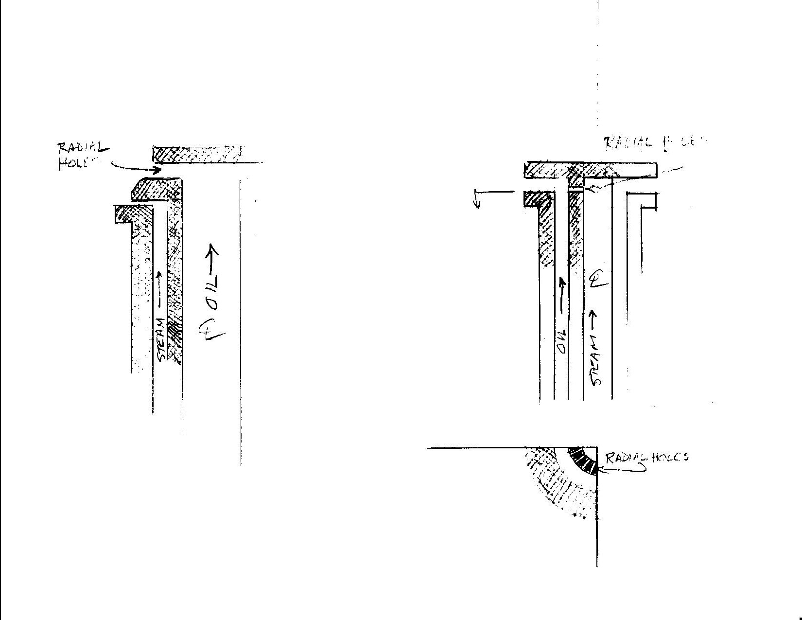

OK, Howard et al, whoever might be interested - from a previous thread, a conceptual sketch of a couple concepts for an oil burner for a small firebox that can be mounted in the middle of the firepan and atomize in a circular pattern. This is a nonvaporizing burner to make use of waste oil of varying consistencies and clanliness, unlike the very good vaporizing burners in use in the UK and elsewhere that are fussy about oil quality.
Hope this goes through OK.
dave

Geez that got huge. Went through OK otherwise.
No idea if the one with the oil running up the center and drooling out over a steam slot would work better than the one that brings the oil up in front of a series of steam holes.
Anybody who wants to play with this is welcome to do so, provided they share their experience with this board.

It looks like a variation of the Von Borden-Ingles burned developed by on the Southern Pacific by those two men. I'm sure it is workable.

Looks like a few of the various old sludge burners.

Looks more like a part out of the heating boilers my dad works with, although it is most likely larger. I can't help but be impressed that there is striking similarities to oil-burning technology in heating applications.

Tom, of course at least one is - if you took the VBI and turned it into a circle, which was the take-off point. The other is a cross between that and the FEC flame thrower combined with some industrial stuff........
I'm thinking that the steamcentric burner might have a tenency to blow the fuel back down the pipe with too much atomizing pressure, kind of thinking out a slightly different arrangement.

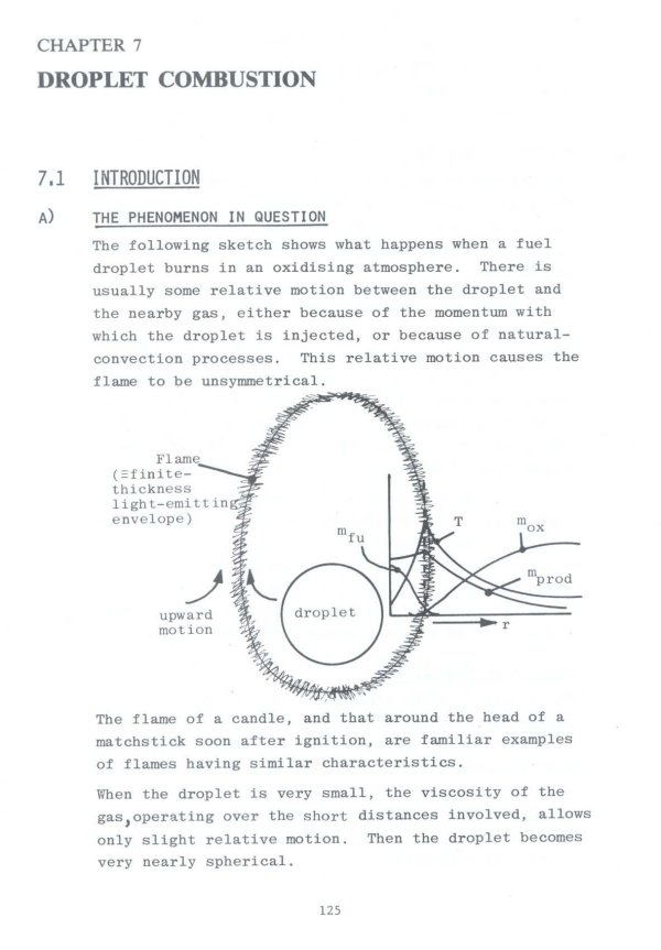

Fundamentals:
1. Flame front is about six to eight molecules thick.
2. Flame front speed is about one meter/second. (Watch any movie where a match is thrown into a trail of gasoline.)
3. The flame is hollow.
4. Size of droplet has to be of a size that it will be consumed before it hits the rear tube sheet. Imagine 100 mph from firebox intake to tube sheet. Do the math.
